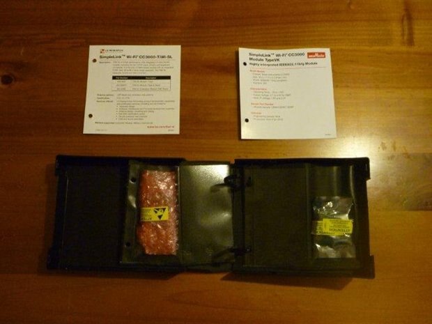

Here are some pictures of the SimpleLink Wi-Fi CC3000 and its contents.
It comes with two SimpleLink Wi-Fi modules. One from LS Research and one from Murata. They are functionally identical.
I've currently using the LS Research module.

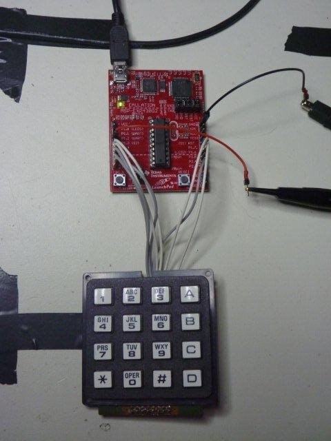

To drive a 4 x 4 keyboard (or the Nokia 5110 keyboard) usually requires 8 I/O pins on a microcontroller when all columns and rows are assigned their own I/O pin.
Although working perfectly on the MSP430FR5739, I am rebuilding it on a slave MSP430G2553 to reduce the I/O requirement (on the MSP430FR5739).
Hopefully this will be a single pin. At worst it'll be 3 (2 input pins and an output pin).
I'll deem the Keyboard slave as a "Micro Input Terminal" as it will transmit keycodes to its host.
21st April
Here is the separated keyboard. For this testing I have temporarily used another 4x4 keyboard. It's wiring is not dissimilar to the Nokia 5110.
This MSP430G2553 has been programmed to output ASCII characters at 9600 baud (8 bits 1 no parity) .
The format output is ASCII SPACE (0x20) + <Row Index << 2> + <Column Index>.
This means the codes output are SPACE,A,B,C,D,E,F,G,H,I,J,K,L,M,N, and O.
The idea is to interface it to the MSP430FR5739 using one of its serial ports thus reducing the required pin count to one.
I've attached the source code for those who are interested.

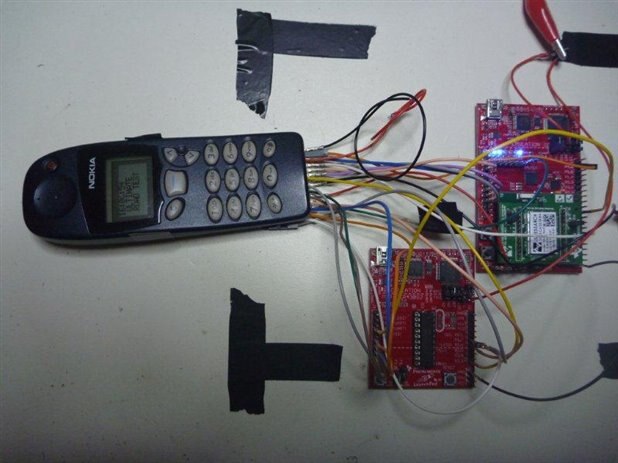

Here's just an updated shot showing conjoined Experimenter boards working together.
There are no LEDs lit on the lower board because it is using external power with the debug interface disconnected and off.
If you look at the LCD is shows that the Real Time Clock is working.
