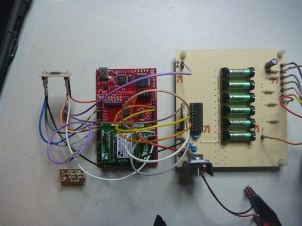

The DAC has been working perfectly generating the desired waveforms and has been disconnected to make way for FRAM driver development.
This is just a progress picture showing the current elements under development showing the FRAM connected to the Fraunchpad and the DAC placed beneath it.
The Relay driver board now has a National Semiconductor LM3940-3.3V linear regulator attached.
Although originally for a uA7805, I am driving the voltage regulation circuit in reverse to get 3.3v from a regulated 5v input.
Since everything in this area is working in reverse with inputs becoming outputs and outputs becoming inputs no PCB mods were necessary.
I annotated the voltage input and output pins to ensure that I would not connected them the wrong way around.
The 3.3v is used to power the Fraunchpad and connected 3.3v peripherals.
