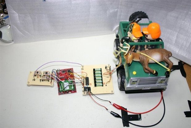

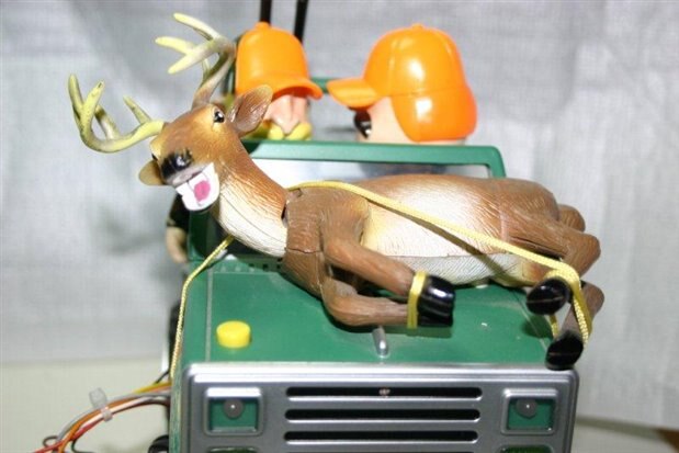

Animated Toy Details
To meet the quirky aspect of the competition, it seemed to me to include a funny toy in the entry.
The plan is to have the toy both convert text to speech and lip sync incoming twitter messages.
This combines the SimpleLink Wi-Fi CC3000 and MSP430FRAM5739 with;

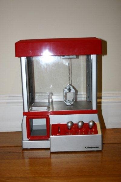

Vending Machine
This is an example of where a food dispensing machine can be easily controlled and monitored from the Internet.
Items used include;
     TI ULN2003 Darlington Drivers
     Relays
     Digital inputs
Here is a picture of the machine prior to modification.
This concept can be extended to other food, paste and liquid dispensing systems.

    Now we know what you have been doing with your time to date.  Hopefully only the toy Bambi was harmed during the photoshoot.image
