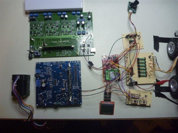

Here is a picture of all modules connected in preparation for testing.
There's plenty here to control a whole building.
Who'd have thought to have so much connected to an MSP430 and have it all wirelessly controlled from the Internet?
.... (Now that's some pudding!)
Just image if you have several of them..... I can rule the world! image

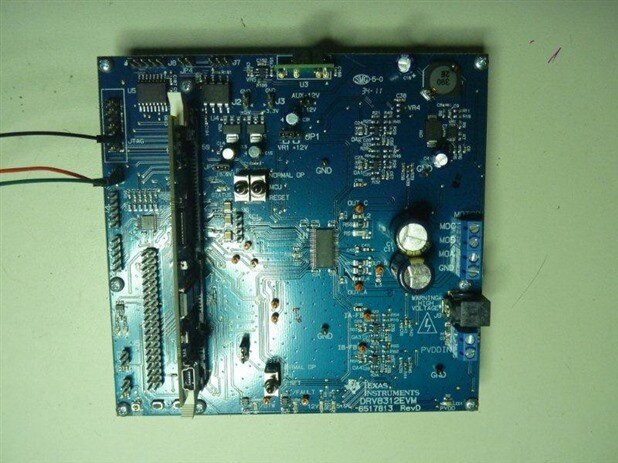

Below is a close up of the DRV8312EVM board and its connections to the Serial Multiplexer/Demultiplexer.
There are no modifications required. The connect tap points for its serial control port are;
     J12 for TX and RX
     JTAG port GND Pin
Easy peasy!
Like the Multi-DC/DC Colour LED Kit, the DRV8312-C2-Kit has its own power supply but this time to provide power to a three phase motor rather than several LED arrays
