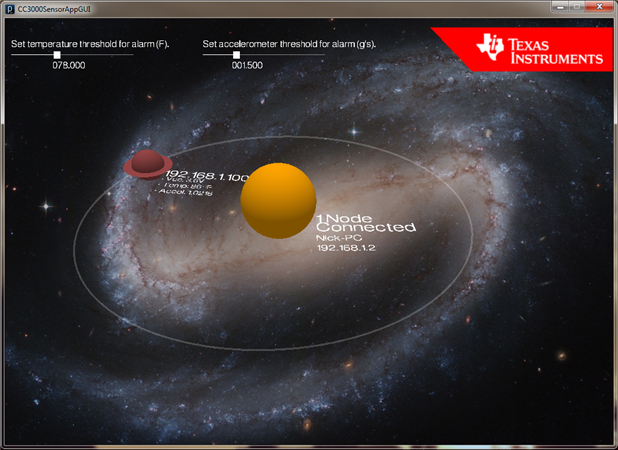

Demo Application
So the first thing to do is fire up the demo sensor application and see what happens.
Demo apps are nice, they show off some of the awesome features of the board and make you feel like you have done some work. The instruction in the getting started guide explain everything you need to know for this stage, they do not give a great deal of detail into what is actually happening though.. I guess they don't want to spoil the fun for later image
When you fire up the demo app GUI your FRAM board will start to collect temperature and accelerometer data right away. The CC3000 sends the data to your wireless access point, and the GUI displays the data using a cool space animation. Don't worry if it takes a while for your FRAM to start it's orbit, this is the AP attempting to resolve the FRAMs MAC address, for some it goes through all of the IP address from 192.168.1.1 to 192.168.1.101 before it guesses the right one. This morning I would have had no idea what "resolving a MAC address" meant (I probably still don't), but I think that is what is happening anyway..

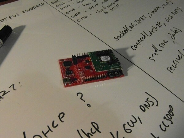

3rd April : How To WIFI
So like I said the other day I have my CC3000 up and running with all the control in the world. The configuration of the CC3000 can be split up into four main parts, and each of them split up into a number of other bits and so on and so forth. Eventually you end up with a huge mess of code, the only way I managed to get my head around it was to get some demo code and break it up into little bits. To have any chance you should make use of three handy libraries that TI have made available, the CC3000HostDriver library, the CC3000 SPI library and the Hyper Terminal Driver library I downloaded them all along with the CC3000 basic application from here.
Get Your CCS Project Ready
Now I did attempt to create my own CCS project and import the three libraries and include them in my own project but I could not get it to work, everything would compile but debug just refused to start (a job for another day).
To get around this I just imported the libraries and the basic WIFI application into my workspace and renamed the project to Bread&Butter. Then I deleted all the source code from the project and created my own main.c file to start off with. The fact that this worked makes me think that the problem is just a small linker setting or something. Your CCS project explorer should now look something like this, remember before you can build your project you must first build all of the libraries using the little hammer button above the project explorer.
The Four Basic Steps
So the setup process can really be split up into four parts three of these steps have to be done every time you turn on the CC3000 and want to connect to the Access Point. The different stages of completion of these four steps are monitored by a state machine with the following states.
Step 1 : Initialise The Driver
The host driver library that we imported doesn't assume where the CC300 is plugged in, the initialisation basically gives it access to some peripherals (digital IOs and such) to control the CC3000.
SET STATE 0x02 (Driver Initialised)
Step 1.5 : First Time Config
This step only has to happen once, it will setup certain connection profiles and handle some other tasks I don't really understand yet. You can also set up different connection modes from here if you want, such as fast connect which will cause the CC3000 to always attempt to connect to the last used AP on power up. Once the first step is finished it will save a value into non volatile memory so it doesn't happen again (unless you force it to). You can use this to setup some intelligent connection modes to skip the next step (hence step 1.5).
Step 2 : Associate With the Action Point
This step will associate your CC3000 with your Action Point, I just force the CC3000 to use the SSID of my action point (TTTcBread&Butter0), like I mentioned before you can use smart connection profiles to skip this step.
SET STATE 0x04 (Associated to AP)
Step 3: Get an IP Address
This step allocates an IP address to your CC3000, you can either use DHCP and let the Action Point allocate your IP or you can use a static IP address. Once this is done check to make sure the IP address is OK, this step is mainly for DHCP if you are using a static IP it should always be OK.
SET STATE 0x08 (IP Address Confirmed)
Step 4 : Open a Socket
Again there are two choices here, you can go for the easy and fast UDP socket or take the time to set up a reliable TCP socket. Of course I went the easy route for now, a UDP socket or "connectionless" socket is super easy because all you do is open the socket and start throwing data at the action point. A TCP socket requires listening and accepting of connections and all it does is give you guaranteed data reception... OK that is pretty good I guess, but it is slower and in this case UDP works just fine.
SET STATE 0x10 (Server Initialised)
SET STATE 0x20 (Client Connected) ---- TCP ONLY
Step 5 : Send Data!
With a UDP socket sending data is really easy, just point it at the IP address of the Action Point and press send. I have not tried  a TCP socket just yet, I will tell you about it when I get there.

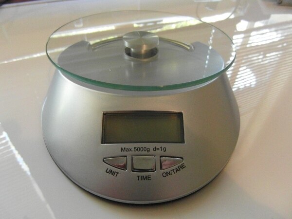

Weight Measurement : Milk & Bread
So the most obvious choice would be to use some load cells under everything and be done with it. That approach is kind of boring, also load cells are damn expensive! So I will measure the weight of just the milk and the bread for now, and think of something clever for everything else.
I have sourced two super cheap digital scales from ebay which I will rip apart and hack to do my bidding, I can not believe that I can get an entire digital scale (with a load cell inside) for about a quarter of the price of a single load cell.

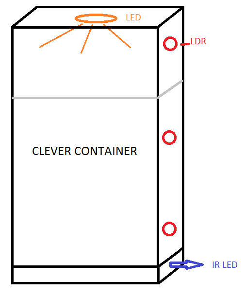

Clever Container Measurement : Sugar & Coffee
My clever containers will be used to measure things like sugar, coffee, flour etc etc. The idea is that I will use opaque Tupperware containers with 3-5 light dependant resistors down one side. An LED in the lid will illuminate the inside of the container, shining light on any LDRs above the level of the contents (and hopefully creating a cool effect). Now wires dangling off the container would cause all sorts of trouble, so each clever container will have a TI mcu (probably a launchpad) and an IR LED which it will use to communicate its content and level to a smart shelf. The smart shelf fitted with a bunch of IR receivers will then relay the information to my FRAM board with the CC3000..... Madness you say? Well, probably...

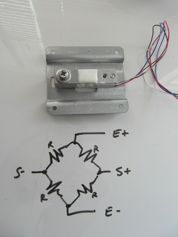

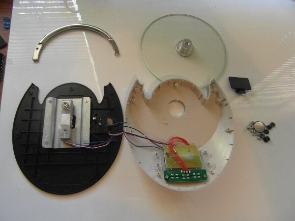

April 14th : Scavenging A Load Cell
Load me Up

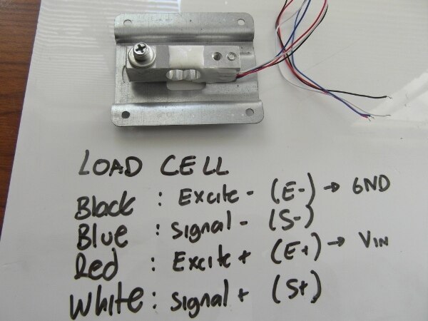

My first set of cheap scales arrived in the mail today and they actually look pretty nice, but all I want them for is the sweet load cell inside. Here are some photos of me taking it apart and extracting the juicy insides.
It Doesn't Suspect a Thing
Juicy Insides
Load Cell Legend
Load Cell Diagram

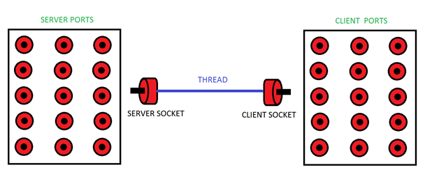

TCP Connections
I think the easiest way to understand a TCP connection is to visualise it, hopefully the picture I drew below makes as much sense to you as it does to me. All of you devices on the network have a whole lot of ports available, to connect two devices they each need to create a socket which will "plug into" a port. The TCP connection will then connect the sockets with a thread which allows communication between the two devices.
Server:
Step 1: Create a socket
Step 2: Bind the socket to the port and assign an IP
Step 3: Listen for incoming connection requests from clients.
Client:
Step 2: Request connection to server

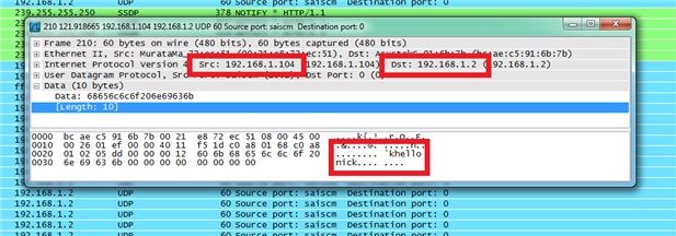

The Code!
Well my code is very similar to the Basic WiFi application demo, just better image. Well probably not but I have made a few changes that made sense to me, the unsolicited events are now handled in an interrupt that runs every 500ms rather than in random while loops all over the place. The CC3000 is setup as a client not a server, I also didn't bother with a lot of the smart config bits and pieces. I made it fairly flexible (I hope), you will find in the common.h file you can change all the network specific variables such as SSID, IP and port numbers, you can also choose to use UDP/TCP sockets or DHCP/static IP. Oh I also commented the bajeesus out of it..
All it does at the moment is send the string "hello nick" every second, but I'm sure you can think of something more exciting to use it for, anyway it is attached to the blog post and you can download it below.

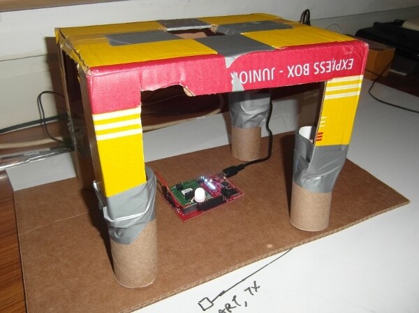

To test and demonstrate my receive function and my GUI I hooked up an RGB LED to three PWM outputs. If you watch the video in full screen you can see that when I turn on the MSP430 board the first 5 LEDs come on to show that the board is initialised and connected, when the connection is established the state is updated at the bottom of my GUI. The sixth and seventh LEDs are the transmit and receive LEDs respectively, they blinks for half a second when any data is transmitted or received. The eighth blinking LED is the heartbeat LED, the CC3000 sends a "." every 500ms as a keep alive byte and the LED lets me know it is still going.
Camera Stand
Fancy camera stand? I think not! Cardboard box and toilet rolls are all you need to make yourself something to hold your camera.. The camera usually sits in the square hole at the top, but in this photo the camera is in my hands.
