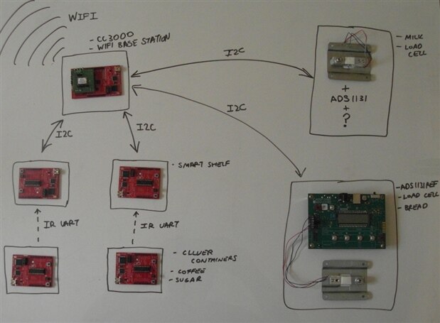

Here we are again, I have some new toys to play with and a few days off work so hopefully I can make some progress on my clever containers. First things first, here is a picture that will hopefully show you how my system is going to work together.. I may have to add some extra bits and pieces to include things like motor and light control. We will see..

    HNTE over 14 years ago in reply to DAB
    The comminications structure is actually what I am working on right now actually..
    First step is just to get boards talking to each other with their various methods (i2c/uart etc).
    I have started working on an instruction format. For example for the RGB LED control, I send a message from my GUI to the CC3000 like this.
    I_L_R100, the I_ confirms that the message is an insruction, the L is an LED instruction, the R100 switches the PWM duty cycle for the red LED to 100..
    Once I have more to talk about I will stick it all in a blog post image
    Cheers
    Nick
    DAB over 14 years ago
    I don't know about an army, but it looks like you have the beginnings of a good squad. image
    Have you defined a communications structure yet?
    I am assuming you will use messages to coordinate each of the processors.
    Your integration issues could get interesting.  Have you defined your test plan?  I find that thinking about testing helps me focus on additional items I need for the design.
    Just a thought.
