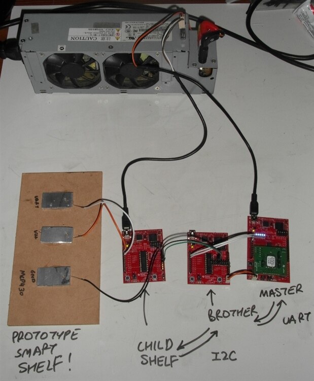

So getting my little network was not as easy as I had hoped. Sure it is simple enough but I kept running into problems or just making very silly mistakes.

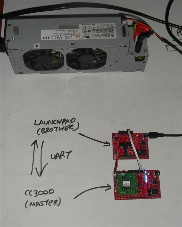

In my last blog post I showed you a picture of how I would lay out my network, with the CC3000/FRAM at the centre I2Cing to all it's children. I ran into my first problem when I realised that the I2C/SPI module was already being used on the board by the CC3000.
To fix this I decided I would use the serial UART interface and use a launchpad as a brother to the CC3000/FRAM board.
Brotherly Love
You can see in the picture below the master FRAM board connected to the brother launchpad and my re-purposed ATX desk power supply with a chopped up usb cable to power the whole lot.
One convenient off shoot to this setup is that I can let the brother do all of the work looking after all of the sensors so that the master can do more important things like talk to the computer (overlord?)...

So the test setup looks something like this.. The mdf with the three aluminium tabs on it is my prototype smart shelf, I have moved away from IR communication for something better (but that is talk for next time).
Next time I will show you some of my I2C code and also describe my new idea for communicating between the smart shelf and the clever containers.

    DAB over 14 years ago
    Hi Nick,
    You might want to keep your eye out for potential ground loop problems.
    You might consider adding some optical isolators between the boards so that you do not create an artifical ground loop between the boards.
    Your wirelessly connected nodes should be OK, but if you have wire connections, you might get into some problems.
    Other than that, it looks good.
