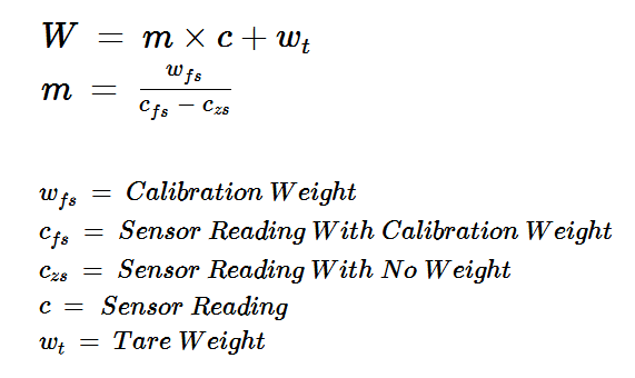

The other day I managed to communicate with the ADS1131REF board via serial, but I was left stumped by the data I was getting. Turns out I was just being an idiot, the data returned was not weight data but the raw voltage reading from the output of the sensor. To convert the raw voltage to a usefull weight I needed to calibrate the sensor (of course!). The claibration uses the simple equation below to convert the sensor reading to a calibrated weight.
