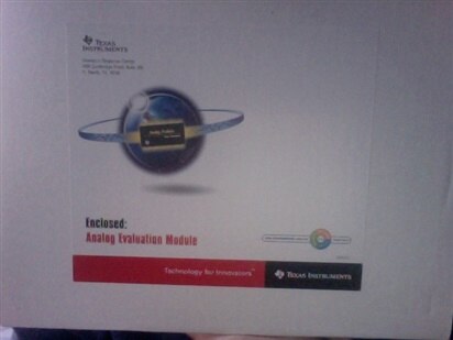

First up is the light component of the project, the LED driver. Based on the requirements, the TPS61042EVM was chosen. In the ever so slightly misleading box you will find three things, the evaluation module (actually really tiny), the manual for the EVM and a datasheet for the part. Yes, this particular EVM contains printed copies of the documents. There is a lot of discussion going on about paper copies of documents such as this, a quick search will show you a few on element14, but personally, with parts like this is a great help. On the times you are setting up a EVM to use and finding you are rapidly running out of space, a laptop can be a little inconvenient, where as a paper document you can easily move around or lie one top of things without risk of damaging them is rather useful.

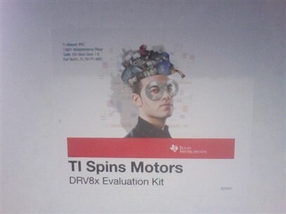

Second up is the motor driver, in this instance it is the DRV8805EVM. Chosen for its stepper motor capability, in particular the step function and direction control, this IC should make the driving of the blind much easier. In the box is the PCB holding the driver IC and a MSP430 to control it. Should you just be after testing the driver, the MCU can be bypassed so you can control the device with your own signals. Also present is a handful of test points so you can monitor exactly what is going on. The box contains a USB lead so you can program the onboard MSP430 with your applications or the demo applications. Sadly this kit does not include any datasheets like the LED driver kit, they are all available online however.

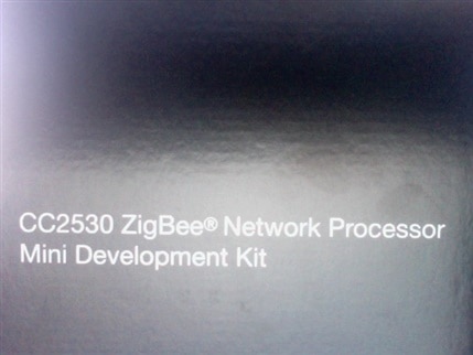

Last up is the networking portion. Although this project uses WiFi for the control part, it is designed to be able to control different rooms. Doing this with WiFi would be a little impractical, however there is a nice little protocol designed for this kind of task, ZigBee. This protocol has a few application profiles which demonstrate what it is good for use in, one of these is a Home Automation application. Taken from Wikipedia on the subject, typical uses include “Home Entertainment and Control — Home automation, smart lighting, advanced temperature control, safety and security, movies and music”, so essentially what we are aiming for. To make it even more suitable, TI have the CC2530 ZigBee Network Processor Mini Development Kit. In the box is a coordinator module and two end devices, each using the CC2530 IC to handle the ZigBee network and a MSP430 to control that and hold your application.
A few notes about these, watch out for the motor kit as it is liable to get hot. Its what happens with that much current! For the ZigBee kit, users in Japan need to pay attention to the local laws. The kit contains a useful leaflet about the requirements for using it (Suitably protected lab etc), make sure you pay attention. Finally, the LED driver kit contains its own LEDs which unsurprisingly can get a bit bright. You may want to take some precautions around this like a filter over it to dim it slightly. The user guide also warns that the device may get a little hot (60C+), so be careful with that. Your own fault etc if you accidentally cook a finger image
