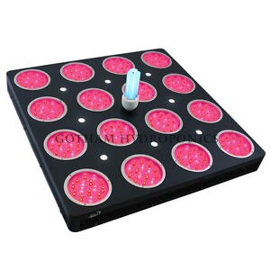

    Green plants don't have much use for green light.  That's why the forest is green.
    These are the jessy currently.  Red+Blue leds with a Cree bulb for the hard-ish UV.
