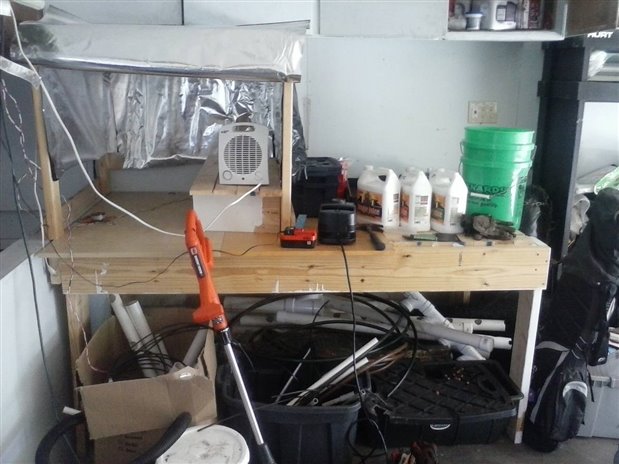

I also lost a bit of time cleaning up the horrible mess my garage has become this summer so that I have some room to build my system. Below is the space I have to work with. On the left is the seedling chamber I used for all of my starts this spring. It was basic temperature and humidity control using a Moteino and BeagleBone Black running OpenHAB. It served it's purpose for one spring, but it was never intended to be a permanent solution. Actually it was all just thrown together from stuff I had lying around.
