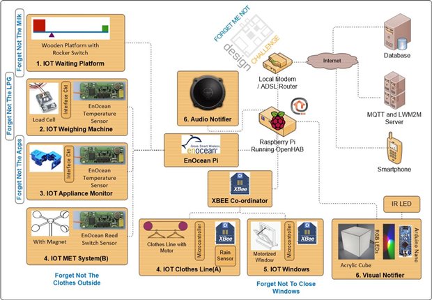

So what are the things that we can forget around the house other than the obvious? Below is a list of the ones I will be targeting. A design diagram is given below: (Note with the RPI B+, I have proposed to add a LiPo Battery, LCD, Keyboard and Mouse along with a Wifi Dongle which will make our SmartHome Kiosk Mobile!)

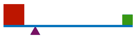

1. Did I put the milk back in the fridge? - IOT Waiting Platform
    Large pots of stew and boiled milk cannot be put in refrigerator immediately. They need to be cooled down and I have forgotten to put the milk back in the fridge on more than one occasion. This applies to any leftovers and things you took out of the fridge and need to put back in later. Now people set alarms and timers etc but when you get to bed or leave the house in a hurry, there is a nagging question at the back of your mind... Did I or didn't I? To answer this question, I propose a "WAITING PLATFORM".
Figure 1: Proposed Lever Arrangementimage
The Hardware: The device will use the EnOcean push switch to transmit whether there is something on the platform or not. The platform will be built out of wood and will incorporate a sort of lever arrangement to facilitate the pressing of the EnOcean Power generation bow in order to generate the power necessary for the transmission of the signal. A rough sketch is given below but the actual device will be designed once I have the sensor physically with me and I can see how best to assemble it in the frame.
The Software: The EnOcean Pi will be used to receive the status and updates will be passed onto the user via OpenHAB. The status will also be pushed via MQTT to a Mosquitto Server where clients can subscribe and check. More on this later.

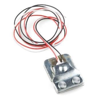

The Hardware: The device will use the EnOcean Temperature Sensor, hacked to take measurements from a loadcell or weight sensor. I think the only way to upload custom code to the module is via the Dolphin Suite and EDK but I will try to figure something out. Worst case, I will map the load cell outputs to the temperature sensor via some glue logic circuitry. The load cell shown below is a 50Kg one and is good enough for our application. It might take an additional battery and a little bit of signal conditioning circuitry to attach this to the existing EnOcean sensor. I will be fabricating a metal hook like structure that will allow me to hang the entire weight on a single cell instead of using a platform with multiple cells which will increase the circuitry.
The Software: The sensor calibration etc will all be done on the RPi. The Data will be passed onto a database to record the level of LPG and determine consumption patterns which can be further used to extrapolate the next time we need to place an order. The extrapolation will all be done in much later stages using either Jquery or something else at client end or NodeJS at server end. Once the cylinder goes empty, an alert will be generated. More on this later.

    Pat Unless I'm mistaken none of the images relate to the words. Mark
