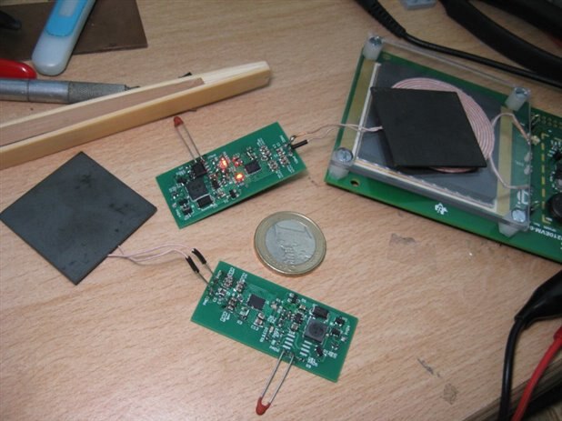

I've finished two boards with electronics, the circuits are working like a charm! Smallest component: 0402 resistor. Largest component: SO8
Euro coin was added as a size reference. The circuit capable of charging 6 NiMH cells combines a Qi receiver, a current and voltage limited boost converter and a NiMH charger IC. And two nice bright LEDs!
    Looks awesome...I've a great idea where I'd like to use this board, can't wait until production units are ready!
