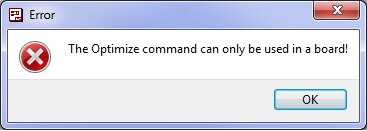

BTW - From a programming standpoint I can see where they are coming from. Rather that writing 3 separate programs for the Library Manager, Schematic Editor and Board Editor, I'm guessing that the EAGLE developers have reused the same functions and components at a macro scale.
This is evidenced by the his error message you can get from the Schematic Editor.
