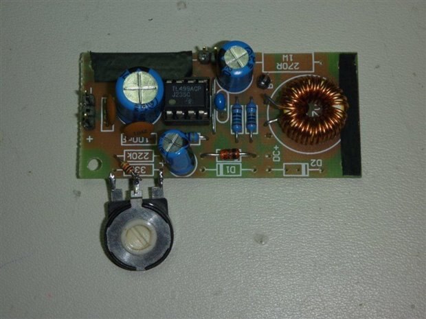

For my initial experiments I have used a Texas Instruments TL499A Wide-Range Power-Controller that I had in my laboratory.
The TL499A is a step-up switching power supply controller capable of a maximum of about 900mW (9V @ 100mA from a 5 volt input).
This part can accept an input between 1-10 volts and output up to 30 volts.
The output voltage is selectable by adjusting just one of its feedback resistors. I've used a 50k trimpot in series with a 10k fixed resistor for testing.

The TL499A is sufficient for initial proof of concept testing but I will need to resort to more powerful to make full use of the available power.
