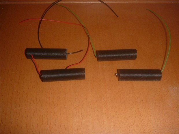

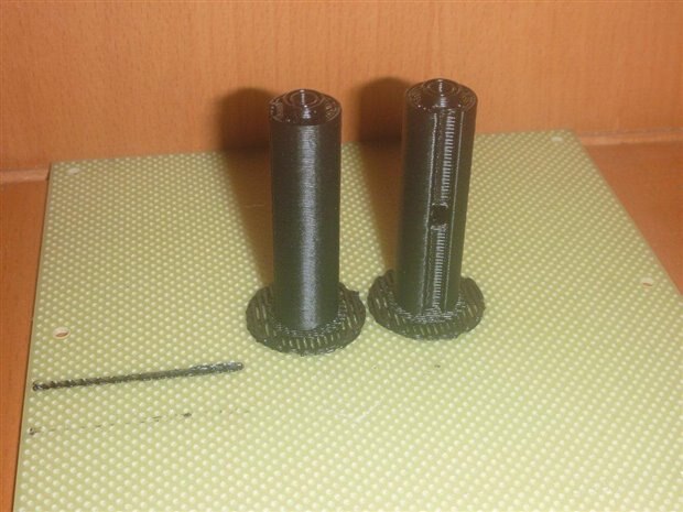

There are some situations where my test clips are unable to connect to devices so I have printed my own plastic AA cells.
The current generation is good with a hole in the centre and a groove to enable the wires to be easy ported out.
On the left are the ones from the picture above (the second revision of of the design). The ones on the right with green wires are my first design attempt
(with smaller axial hole, no groove or central hole). All work.

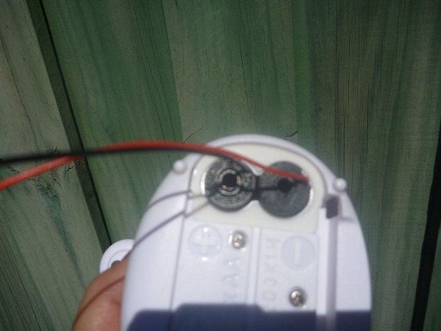

Here are two in a hand detergent dispenser to demonstrate their use. I used copper braid (recycled soldering wick) as the contacts.

    vsluiter over 13 years ago
    That's a very clever idea! I've been pondering a bit over how to use AAA's in an AA device, but I could try printing some tubes to house the cells in.
  • lfa555
    lfa555 over 13 years ago
    very very cool Monte!
    DAB over 13 years ago
    Hi Monte,
    I just used a wooden dowel.  I cut it to length, cut a groove along the side for wires and then used tacks as the contacts.  It gave me the ability to run power to may digital camera from two D cells for extra time in taking long exposures.
    I admit, if I had a 3D printer, I would have gone your route.  I just wanted to share an alternative for all of the people who do not.  Old school still has its uses.
