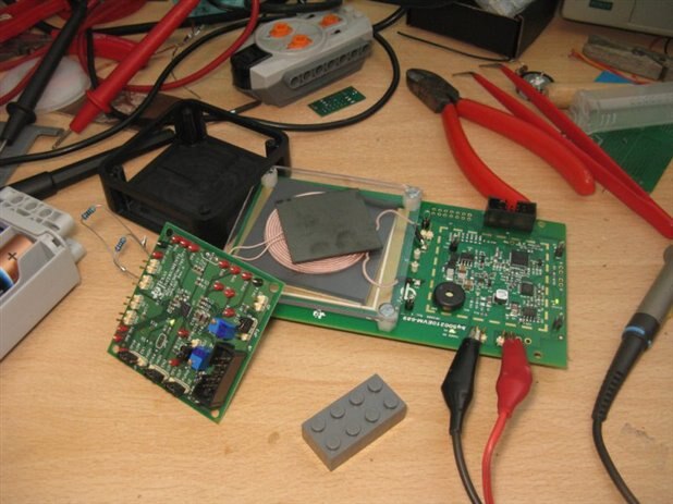

On the hardware side of things, I received the demo boards. Powering up is as easy as shown in the video's, I simply hooked up my power supply to the transmitter, laid the receiver down with the coil on the transmitter, I heard 'beep' and the transmitter LED was blinking while the receiver LED was shining happily! My multimeter showed a nice and stable 5V output. Hooray, I'm good to go.....

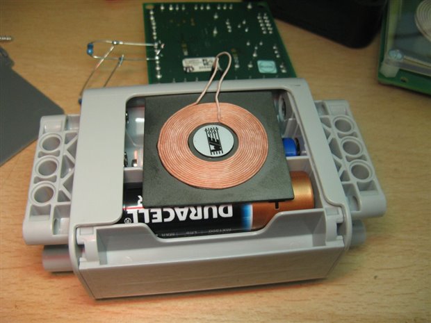

Sorry engineers at TI; I immediately took the receiver coil out of your well-designed enclosure; It's quite nice and small. I attached some resistors to the output to do a bit of load testing, everything has been nice and steady so far.
Close-up of the receiver coil fitted in the LEGO housing; underneath the coil you can see an original AA size battery, but also an AAA size next to it. The AAA gives a LITTLE bit of room for the electronics....
