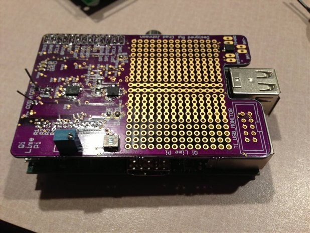

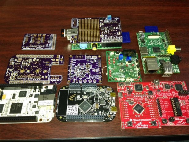

I wanted to post a picture of the many uses of our designs. I have made the Following Qi Powered in the picture below:
-Hot Qi Dog Cape
-Qi Lime Pi Shield
-Qi Lime Pi Slice
-Raspberry Pi
-Original BQ51013 Receiver
-Beaglebone
-Freescale Freedom Board
-MSP430 Demo Board
-MSP430 Fram Demo Board
And tons of other items that use 5V!
I will post more designs in another post even though the competition is over I will still post all files for the Hot Qi Dog Cape for the BeagleBone like I did for the Raspberry Pi.
