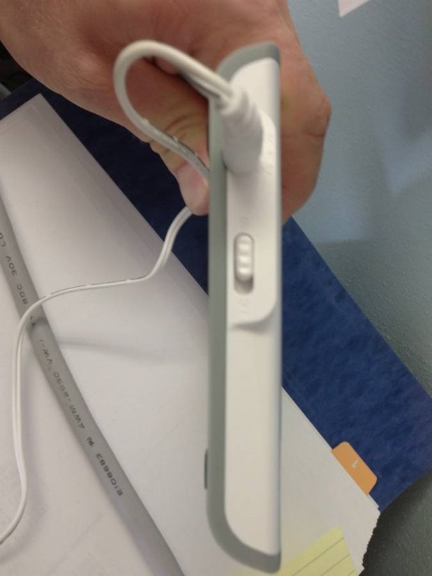

Image of the Transmitter:

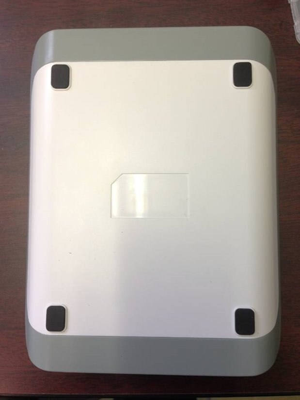

Bottom Side of the Transmitter:

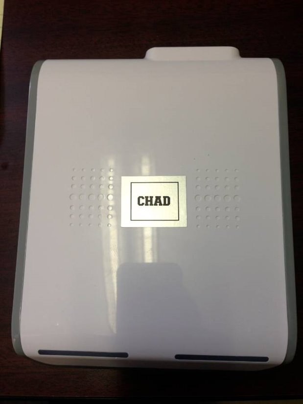

Backside of the Transmitter:

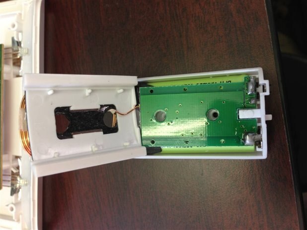

Inside receiver:
Receiver Board:
