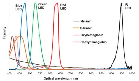

Below are absorption spectra of skin chromphores and LED emission spectra.

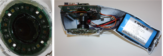

There are 4 LEDs for each wavelength to make illumination uniform. Light from LEDs is sent through a linear polariser sheet. In front of camera is another polariser sheet oriented at 90 degrees. This is a powerful method to eliminate direct reflection from the surface. Skin under investigation is illuminated for 1 s with each color and photo is taken.

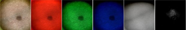

Below is image obtained in white light, red, green, blue, infra-red and ultraviolet illumination.

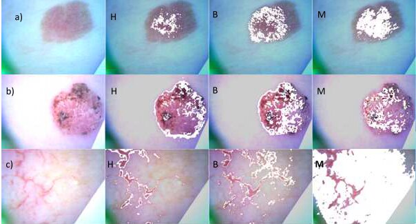

Such diagnostic information can be extracted and mapped on the original photo:
  • Hemoglobin index R/G    H=I660/I545 nm
  • Bilirubin index B/R           B=I450/I545
  • Melanin index G/R/IR     M=I545/I660/I940
Picture below shows white light image and maps of Hemoglobin H, Bilirubin B, Melanin M for a) hemangioma, b) papilloma (wart), c) blood vessels.
