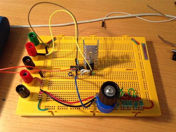

One thing I have noticed is that, in order to check the performance of the transceiver, I will need to test it under different load conditions. I could just connect and disconnect resistors to the output, but there are better ways to do this… an electronic controllable dummy load! While looking through the web I found the great video at the EEVblog where Dave designs and builds a constant current dummy load ( http://www.youtube.com/watch?v=8xX2SVcItOA ) . So I quickly decided to go his way and try to build it myself.
So this post is going to be about my dummy load. A little bit off topic, but better than nothing while I’m waiting.
First, a Bill of Materials:

As I didn't have a MTP3055 laying around I used a IRLZ24N.
For simplicity I decided to not connect the display Dave uses in his version. Instead, I mounted to additional banana Jacks to connect the Ammeter directly.
Next thing was prototyping the hole thing:
And finally soldering it all together in a more durable manner.

I tested it with a 5V supply and was able to draw up to 1 A. With a 12V supply it got up to 2.5 A. Nevertheless I did not try to let it working at that point, as the only heat sink I could get is far too small.
