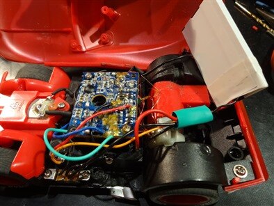

It turned out that inside these RC cars there is usually not so much space left. So I was not able to fit a larger LiIon battery in. Thats why I settled with a 650mAh one (its actually a phone battery). For charging I built a small circuit using the LTC4054, since it needs just two external components. I already used it for my wireless charged night light, so I had some experiences with it. I built the charger on a small SOT32 breakout board, and isolated it with heat shrink tube (the green part in the picture above).

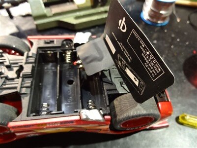

To connect the Qi receiver I drilled small hole in the battery compartment. Originally I thought I might put the whole circuit there, but its to small to fit a LiIon battery (I would need to look for a square one):
I wired up everything so I can easily remove the additional circuit

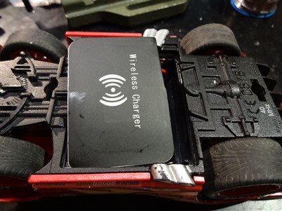

So the receiver just fits on top of the partitions, but I need to fold it. Then it fits perfectly into the space reserved for three AA cells:

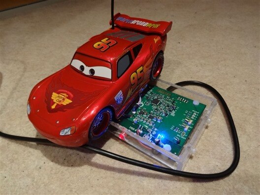

After wiring everything together, its time put the car on the base station. And there it sits, charging its battery proudly:
I used clear acrylic for the enclosure, since its easy to handle, and I can re-use the internal LEDs for monitoring. I just added a current sense circuit with an attached comparator to drive a red LED (the one in the front). It turns on then the base station draws more than 500 mA, which is about the current drawn during charging. That way I get both a signal when the toy is positioned correctly 8the LED turns on) and when charging has ended (it turns off again).
