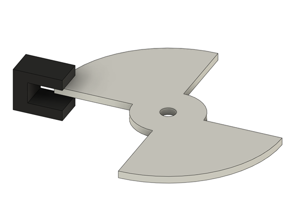

My first ideas were using the phototransistor for measuring rotational speed of the wheel. I wanted to put a small plastic circle thing on the axis of the wheel, cut part of it out, and mount the phototransistor on the side, something like this:
I didn’t want to tear my bike apart to somehow mount this, so time for plan b:  mount the phototransistor on the fork, and make something that sticks out to the side from one of the spokes that the phototransistor can detect. Not as elegant as the previous idea, but much easier to implement.

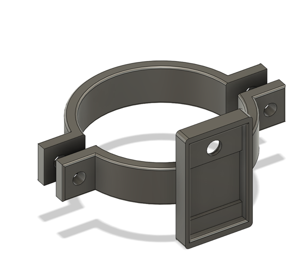

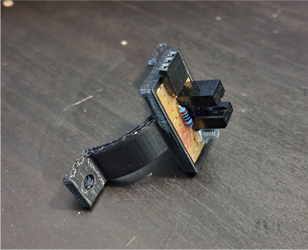

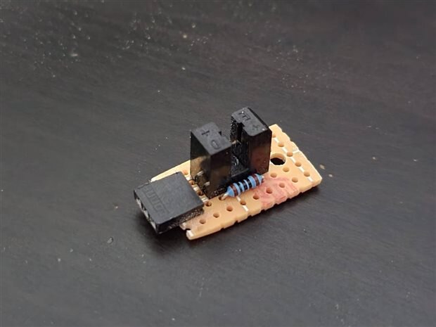

Soldered the phototransistor to a small perf board, added a resistor for the emitter side, drilled a hole for mounting, and added a 2.54mm 3pin header.
Designed a mount for this PCB, and printed it out of PETG
So that’s the speed measuring part done.

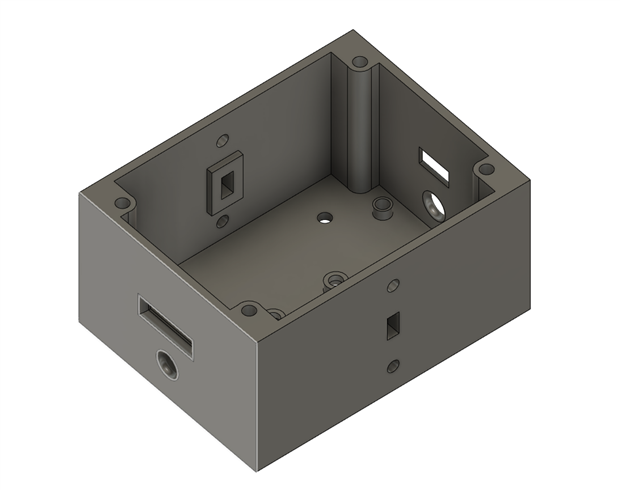

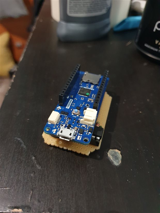

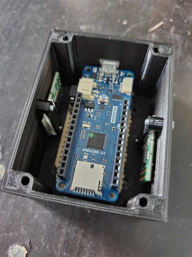

The main box
The Arduino, DHT11, ToF Sensors, MQ135, Opamp + Buzzer will live in this box, along with the Temp Sensor to make sure things don’t overheat.

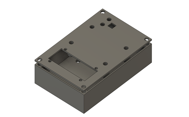

I put the Opamp, Temp Sensor, Buzzer, and some pin sockets on a perfboard, and cut it to size

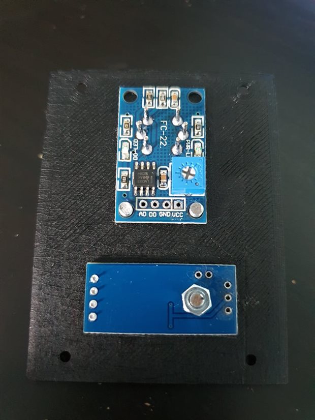

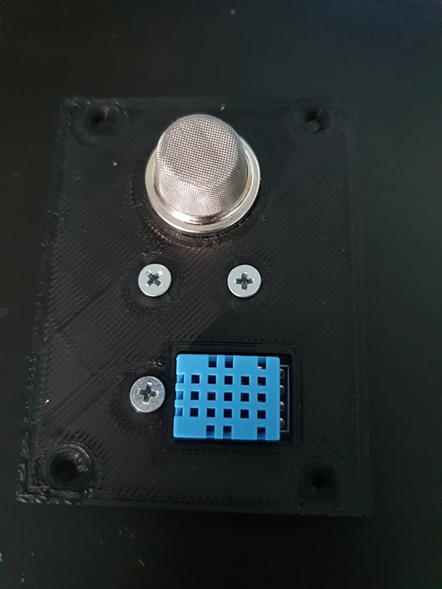

Top panel went smooth as well, just 2 cutouts and mounting holes for the Air Quality Sensor and DHT11.

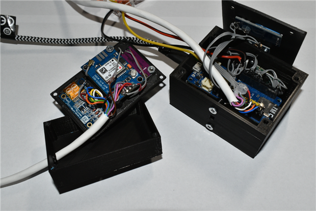

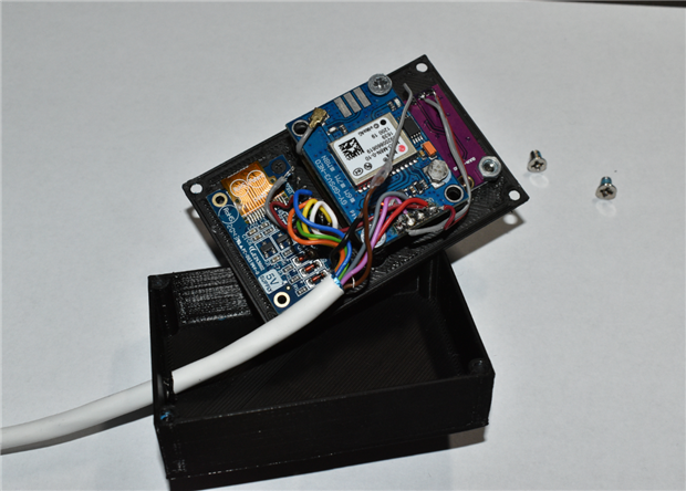

All that’s left is wiring for the main box, but first, let’s design the user facing box with the OLED Screen, GPS, and UV sensor
User facing box
Mounted all the components and wired up everything
With this, hardware assembly is done:

DHT11 Temperature
This sensor uses a one-wire interface, which didn't seem like an issue at first. I connected the VCC pin to 5V, and the DATA pin to the MCU through a voltage divider to turn 5V signals into 3.3V (the Arduino MKR Zero is a 3.3V board). Later I realized this won't work, as the DATA pin isn't a unidirectional pin that only sends data why.
The datasheet of the DHT11 says it needs 3.5V at least, so it can't run off of 3.3V, but let's try anyways.
Turns out it does work just fine with 3.3V, so that's good, saved me from a few headaches.

MQ135 Air Quality
As this device has only an analog output pin, it's really easy to use. Connected 5V to VCC, added a voltage divider to the AO(Analog Out) pin, and connected it to analog pin 2 (A2) on the Arduino.
According to the datasheet, the highest voltage it can output is 4V, which corresponds to the most contaminated air measurable. Since I used a voltage divider, this becomes 2.64V. I used the Arduino in 12bit ADC mode, which is the default and more than enough for this purpose, so that means there are 1024 different values the ADC can return(0 = 0V, 1023 = 3.3V). I calculated the maximum output of the ADC connected to this sensor to be 818. This simple function will give an air quality reading from 0-100 where 100 is the cleanest possible air:
