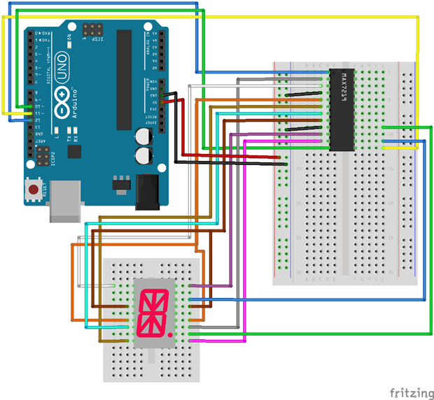

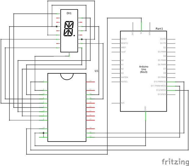

The Arduino platform is great for making LEDs blink and driving small displays, but what happens when you need to display more complex information? For Project ColorTyme, I need to drive 6x 14-segment "starburst" style alphanumeric LED displays, but pins are at a premium. To solve the problem, we'll incorporate the MAX7219 LED display driver; however, it's an imperfect solution: The displays I'm using are common-anode while the MAX7219 is a common-cathode driver. In this video, we'll walk through wiring a 14-segment display to the Arduino, then wiring the MAX7219 to drive in common-anode mode while adjusting the code so everything comes out correctly.

The main thing to remember when wiring in this inverse method is that the segment pins correspond to individual digits while the digit pins correspond to individual segments. This illustration is also limited to a single 14-segment digit, but the pinout for a dual display is what is wired.
