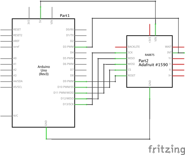

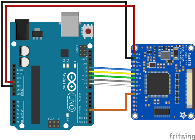

THE CIRCUIT:
It's a fairly simple wiring job here using the hardware SPI interface on the Arduino. CLK, MISO, and MOSI connect to 13, 12, 11 respectively. CS, RST, and INT are defaulted to 10, 9, and 3, but can be reassigned in the sketch. Of course, the display is not illustrated, but it is connected to the 40-pin ribbon connector on the left.
