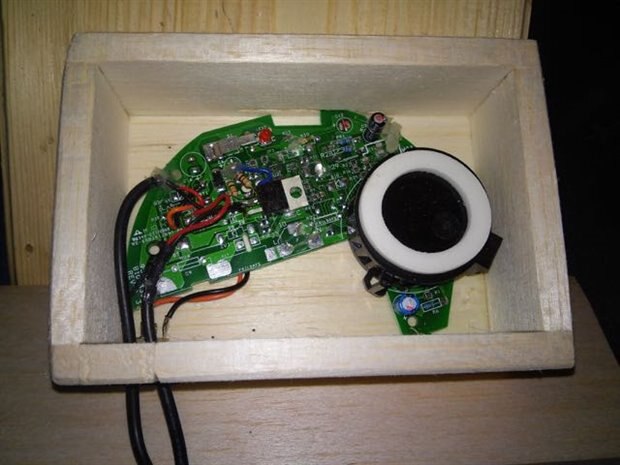

new case for the smoke detector
my original idea was to steam a sheet of wood and bend for a curved back for the case until i looked at my wood supply and realised i had used all of my 3mm thick balsa on another project (macbook cooling stand for decreasing the cpu temp by about 20 degree celsius) so i went for a simple box for the circuit board i added some velcro onto the top for psu to attach onto, i fixed the power cable socket onto the side and left a small gap for any cables to run in and out this is also where i an thinking of adding the usb charger to (maybe) this is still unfinished at the moment as i need to add vents for the smoke to be able to get in and out of the case for the detector to work properlyimageimageimageimageimageimageimage
