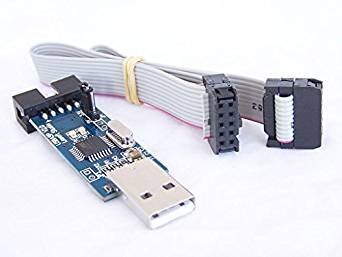

    Programmer - Pretty much any programmer for AVR that has the 6pin connector
    That is pretty much it for the moment, Probably want to get two of the Atmel units. I have a plan to use one as a signal generator for cam and crank signals.
