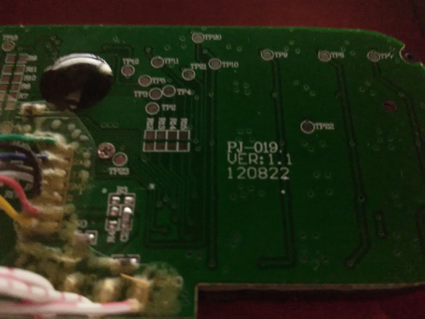

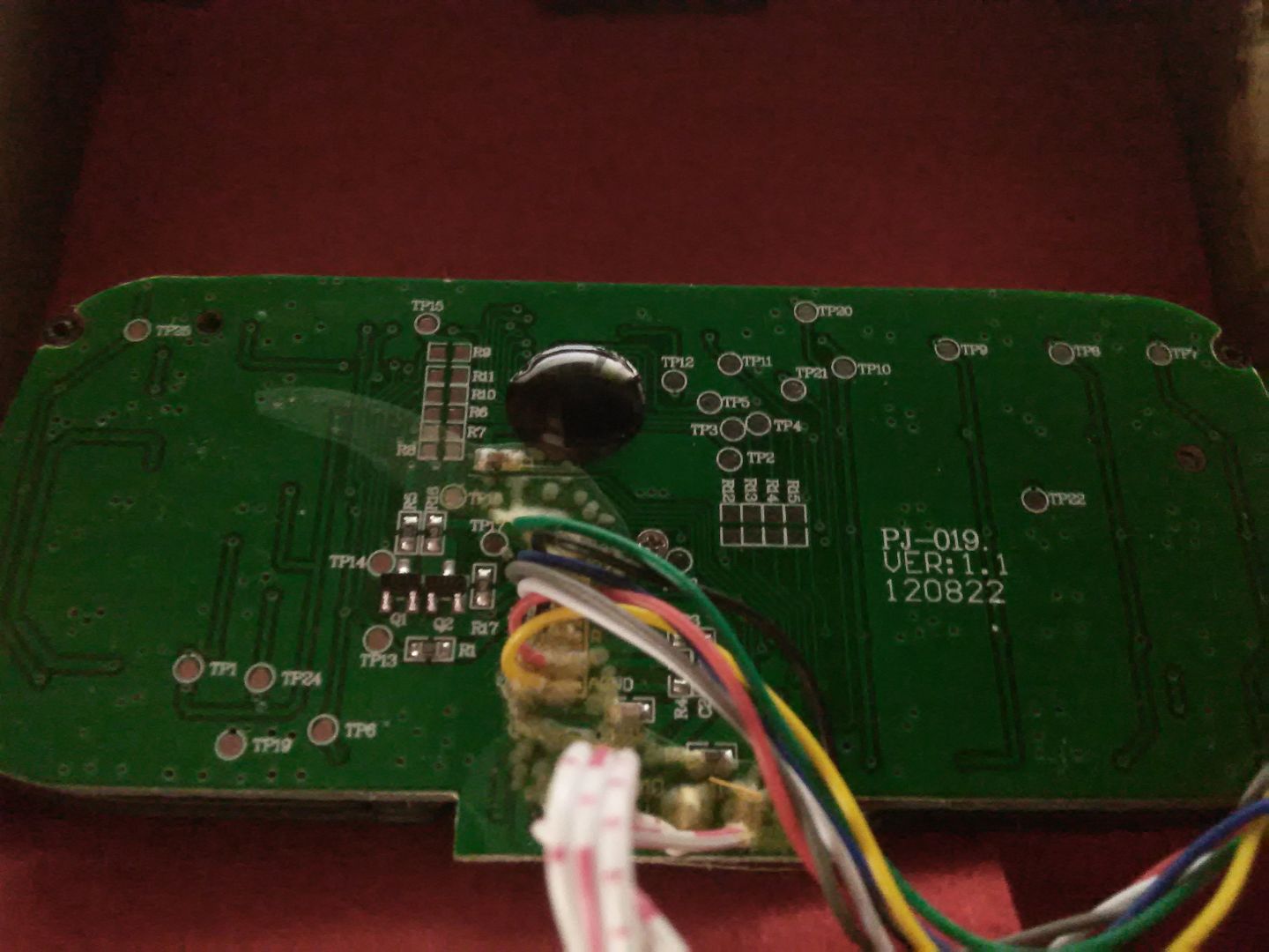

Hey everyone,
I'm interested in modifying a $5 chatpad from ebay into a usb compatible mini keyboard, suitable for PC, Arduino, etc
Altho I may need some help and guidance, I'm familiar with some basics but not any experience with actual modding hardware
The model is TYX-517
the  board is marked with;
PJ-019
VER:1.1
120822
 photo IMG_20151224_093823.jpg photo IMG_20151224_093849.jpg photo IMG_20151224_093916.jpg
is it possible to hack?

    The one I have doesn't have a giant chip to connect to (its NOT an official Chatpad), it only has a single Chip-on-board Blob, there are various hot points around for some sort of Testing points and Resistor mounts, and the main output seems to be TTL
    but that's something I'm new too, but I have researched it which lead me to buy a USB to TTL Micro controller (RS232) in the hopes of using it to convert the signal as one option.
    I also got a PICKIT 3 with the
    RS232 - PL2303HX (here)
    UPDATE 2,
    after looking at the board, i've decided to scratch the Chip-to-Board off and use an arduino mini as the main processor for the inputs, I just need to de-compile how the PCB is mapped
