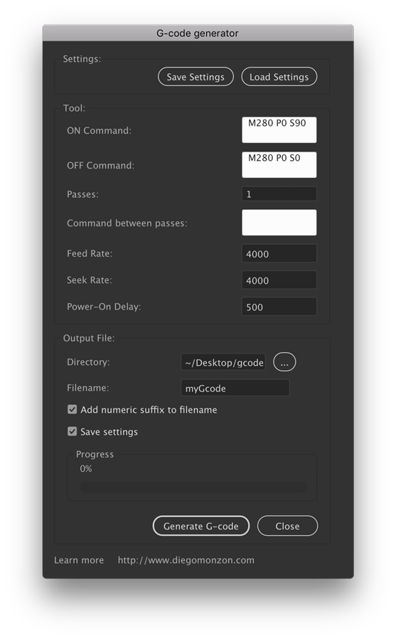

  • diegomonzon
    diegomonzon over 8 years ago +1
    I published this you will probably find this tool useful. https://diegomonzon.com/illustrator-to-gcode/

  • diegomonzon
  • gnatman
    gnatman over 8 years ago in reply to diegomonzon
    I cam across this thread trying to use your script/ plugin thing for making my laser engraving/burnings. I'm really familiar with illustrator but not making my own scripts. I'm curious what it would take to request an option where the gcode can change intensity. I'm looking to use your code to make gradients and what not.  I was trying to use one on inkscape but I can't get it to work properly. I'm not sure whats going on with it exactly but the image I convert using the inkscape code is ghosting.
