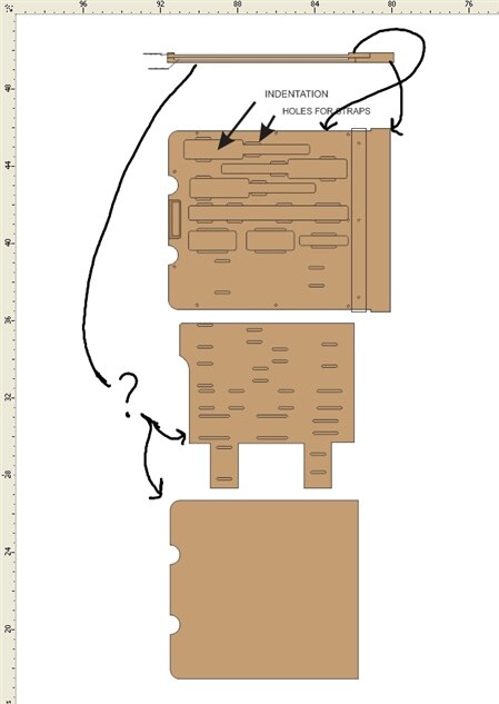

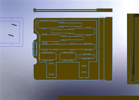

    This part has me a bit puzzled. Here's how it looks when I import it into Solidworks:
    I can't find it on either half_inch_sheet_1.dxf or half_inch_sheet_2.dxf.
    e14 Contributor over 15 years ago in reply to e14 Contributor
    im using the AI file in corel draw X5, and if you actually drag the objects off of eachother you will see that the section with the two 'legs' at the bottom is the piece behind it, and the rest is hard to explain, but ill draw a driagram later image. just letting you know that someone is trying to help image.

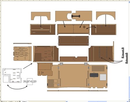

    ok,
    I have been watching the video over and over, and I have come up with this ^ ^ ^ . Yes, from the video, he places tools in elastics which are attached hidden behind that 'middle gap' and a loop is created on the outside for the tools to be held in.
    The most confusing part was where everything went (for me), and I have now figured that all out atleast. Now to figure out HOW it goes together :/ . image .
    If you or anyone else would more detailed 'explosions' of any part of the file, or the file itself, let me know.
    Thanks, -jcolefran

    It looks like those toolholder doors with the elastics would have to be some kind of plastic. It appears they started out as quarter inch thick material, and they are cut down over most of their surface to about an eigth inch thickness. Also the 2 small black pieces on the far right look like they are intended to hold cables and made out of quater inch plastic. Although they might be ready made parts.

    All of the brown 'stuff' is half inch plywood ! and there are a few plastic spacers, metal hinges etc.
