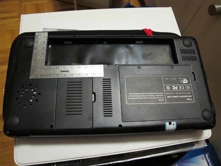

I have a no-name netbook that I got a few years ago and the battery life only has 1 hour left. I'm trying to find a replacement battery for it but I can't seem to find it. I have no part number to go by. It would be awesome if you or anyone here could help me rebuild the battery by replacing the cells inside. Maybe you could even make it better!
I appreciate any help I can get!
Ray

    I would do that, but It will cover the air holes on the bottom. The battery is located near the front, under the arm rest area. I plan to ditch the battery housing and just stuff it in the battery compartment. the battery can't be wider than 40mm. 45mm might get in the way with the pcb.

    I know i can go nuts, but I want the laptop still be portable. The sony P (knock off) won't be portable anymore with a huge battery pack under it or on top of it. I just want to know if it's still safe to use the 3650mah batteries.

    Can someone tell me if it's safe to use the 3650mah batteries, when  the battery label says 3800mah?
    Here's a photo of the laptop. I have no room to fit any other larger cells and the battery is located on the front of the laptop. so if it's raised, it will be awkard for typing.

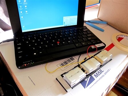

    Hey guys,
    So I bought 6 1700mah batteries and hooked 3 of them up in parallel. So the total mah should be 5100mah right?
    But my battery life is still 1 hour. Did I do something wrong?

    syscorp over 14 years ago in reply to rayjai
    i know little about battery chargers.
    1. chip may have shoutdown - as soon as it detects voltage out of range it will stop working for ever (do not disconnect cells before connecting new ones and use it carefully)
    2. chip may have memory so it does not allow to work longer than it thinks You should - maybe there is battery test option in BIOS (enter during startup)
    3. some batteries may have the possobility to be accessed through software under windows - may test capacity or replace contents of eeprom.
    wanted to do similar thing as You do. finally quit.
    There is also option to use external battery pack with charger and connect instead of power supply - not convinient for sure.
