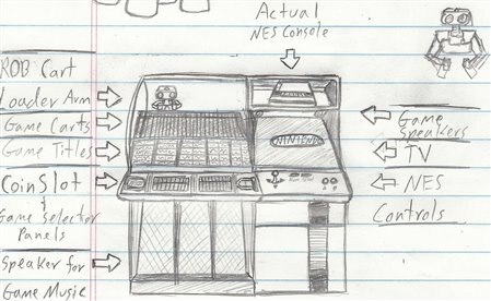

NES-CADE Jukebox
Collecting for classic game consoles is a lot of fun,
but browsing through your collection on a plain shelf can be quite boring.
Challenge:
Build a Jukebox that can hold 100 NES game carts  and
load them into an NES console inside a stand up arcade machine.

    Another route would be to make a custom pcb with connectors for as many game carts as you want mounted in series to the connector on the motherboard. Except for the +5 volt pins on each of the connectors…

    An obvious question here would be "why not just emulate it?" but that isn't nearly as cool as your idea looks.
    I think what you'd have to do is make a custom cart loader when it goes into a position and the contacts clamp onto it, versus pushing the cartridge into a standard card-edge connector.
    The reason for this is that the force required to insert a cartridge is fairly significant if you're trying to do it mechanically.
    Your drawing is very good and this could be a great project for Season 3! Thanks!

    If the NES was a ZIF connector (ts been years since i hacked one to pieces), then all you would need (lol, says me) is a cage that houses the carts, then something like an arduino controlled arm that, rather than selects the cartridge, just inserts a 'custom' zif conector onto the cart contacts (perhaps small support underneath to ensure good contact).
    Then the harness can simply be extended across via long ribbon cable (Ben, I know you like ribbon cables....) across to a small NES mobo in the arcade cab, then just extend controller contacts to buttons and joystick on the front.
    Perhaps taking the NES to the cart would be far far easier than taking the cart to the NES.
    It lends itself to other cart-based machines as well then...... not in the same cab of course....

    Another route would be to make a custom pcb with connectors for as many game carts as you want mounted in series to the connector on the motherboard.             Except for the +5 volt pins on each of the connectors they would have a push to open push to close switch connected between pins 30 and 31 of each cartridge sockets to a +5 volt rail from the connector on the mother board then when you want to play a certain game push the button for that game and it only sends +5v to that cartridge and it starts the game when you power on the nes. This way you still have the tactile feel of a jukebox without all the mechanics and wear of the cartridges.

    This is what i am designing in my head right now.  Its going to be way easier than a robotic jukebox.  I plan on making an array of 10.  I plan on pcb building card edge connectors unless someone knows of a ribbon cable with card edge connectors so i dont have to solder 72x10 wires??
