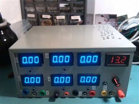

So I've been working on a Power supply that will be able to power my creations during development.  I went online and found some cheap current displays and voltmeter. using an ATX power supply, and a spare 24V 4.5 amp power supply.  I built this.  It is capable of delivering 5+amp from 3.3V, 5V, and 12V.  the variable control allows for 0 - 18V and can source 5 amps Max. Also have a -12V supply and -5V supply.

    I like your random hole drilling work for the air flow Nice job indeed to re-purpose cheap PC PSU. Got inspired to re-use old 600Watt'r without a host

    You need to take care with PC supplies - although cheap and powerful you don't have any current limiting so you can easily fry your prototypes. When I start up a new board with micro or other low voltage…

    That is a very nice build! My only question is about the accuracy of the voltmeters. Are they precise enough for most jobs or do you need to use a more accurate master to get a useful measurement?
    When I start up a new board with micro or other low voltage stuff on it I usually set the power supply current limit to a few mA and slowly wind the volts up, you have to increase the current limit according to the circuit you are testing as the volts go up but that first 0.5 - 1V at a few mA is good for finding shorts or reversed parts.
    You can put a resistor in series with the 3.3V supply to start things up - not quite the same as a current limit but will help you find quite a lot of faults while keeping the magic smoke where it belongs.
    Once things are working having  a cheap beefy supply is nice.

    That's a good technique
