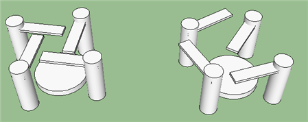

    Updated Thoughts:
    But still... hmmm...Rotating...rotating....ROTATING!
    Instead of a 3d square grid, why not a cylindrical  building system?
    The build table would be built like a turn table surrounded by z-axis towers each on their own turn table.  A curve or arc arm mounted on the z-axis tower would hold the extruder.  These arms will need to be long enough to reach over the center of the turn table so that the center of an object could be filled.
    This would replace the x and y-axis with a polar grid being drawn by an arc.
