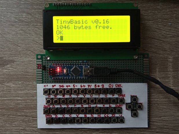

  • josephchrzempiec
    josephchrzempiec over 11 years ago in reply to benheck
    Hello Ben i been following your videos for some time now and i must say you are doing a awesome job man. I know a lot of hard work  that i not  show in the videos. i just recently developing a pocket pc using arduino. and i looked at your coding and you did a awesome job thank you. i have a hard time coding or hardware of things or to even get started my self but watching your videos it help me a lot thank you.

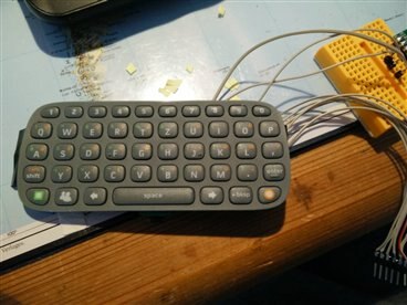

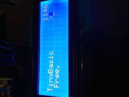

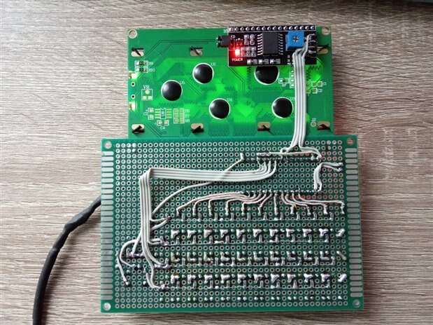

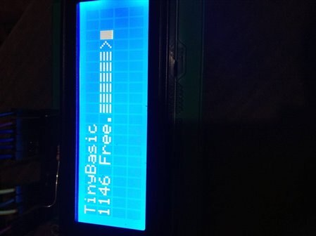

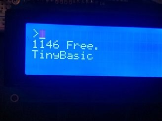

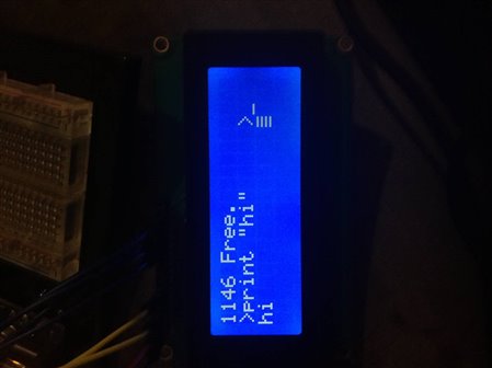

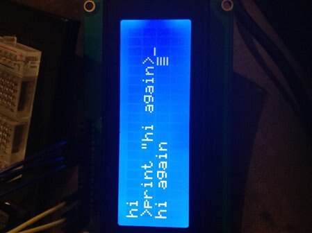

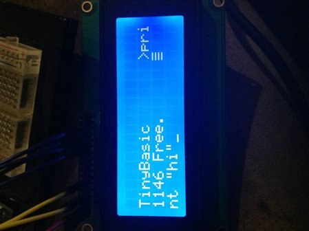

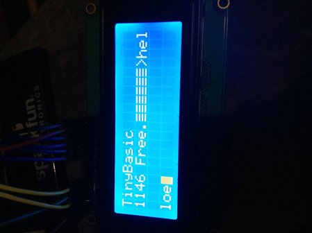

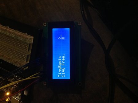

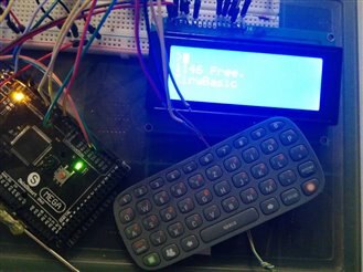

  • muessigb
    muessigb over 11 years ago in reply to benheck
    Your project is great.
    I am still working on it, but for some reason the LCD is still not working.
    I already developed a driver (based on the work on Cliffleblog) for the Chatpad, but the LCD is just not working.
    Here are some photos of the LCD and the project components.
    The mega will later be replaced by a single ATmega328p and the blue LCD is going to be replaced by a green one (HD44780, 20x4 aswell).
    I hope anybody, including Ben, whose show I really like and follow since years, can help me solving the LCD problem.
    I am using the code from github that was posted earlier here in this thread.
