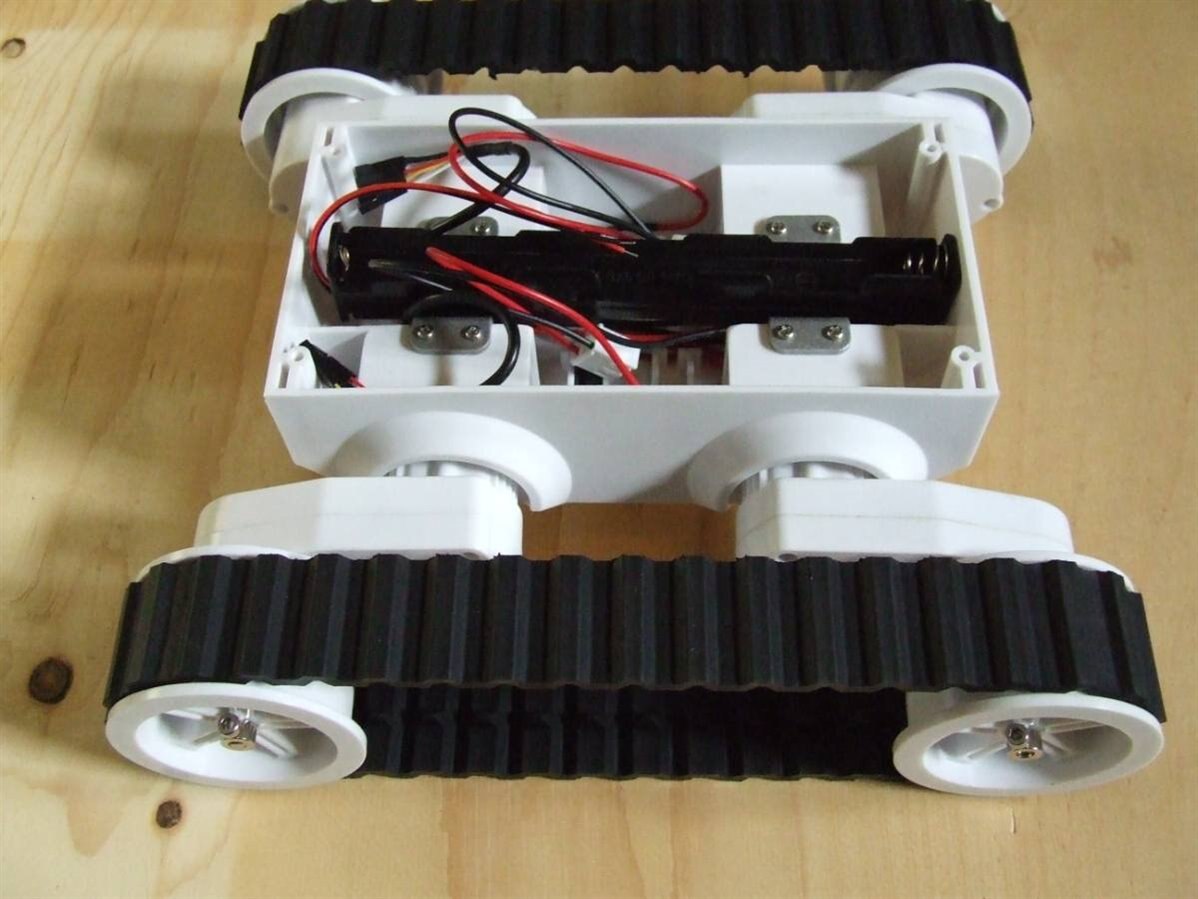

    Ready made chassis such as this one could also save time:
    ROVER 5 - Robot Chassis
