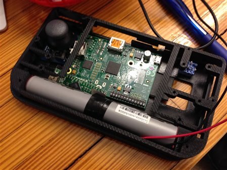

So I've begun slamming through my portable pi / mame build.  So far it's going amazingly well.
I've got all of my parts 3D printed and my pi slimmed down.
I have my analog stick in place and working on button arrays as well.
I've split my battery to change the orientation and that's when I started to get curious.  I may have missed it in the trillion times I've watched the videos, but how and what do I wire up my batteries to?  I am using the same exact setup and parts as Ben did, but I'm left with a red and black lead (+ and -)  and if I wire them into the screen then I can't charge.  Do I need a charging board that will allow load / batt etc?
If so, which board did Ben use?  Or did he build one himself?  Based on the system he setup, is there an off the shelf that will work?  I'm thining the wiring will go like this:
Barrel Connector ----->  Chargerboard Input
Battery leads ----> Chargerboard Batt
Chargeboard Load ---> LCD
5V tap on LCD ---> Raspi
All else is going great, so if someone can clue me in there that'd be amazing.  image
Oh and here's a shot of my progress so far:
--Josh

    I believe those batteries had their own protection circuit, though I could be wrong, if they did, he re-used it.  If they didn't, I doubt he added his own and probably just went in series with them.
    As for charging, he's using a universal battery charger by Tenergy, like this one
    http://www.amazon.com/TLP-2000-Tenergy-Universal-Charger-3-7V-14-8V/dp/B001BEXDRQ/ref=sr_1_5?ie=UTF8&qid=1378945302&sr=8-5&keywords=universal+charger+tenergy
    It doesn't load balance, so its not the best, I think the board the battery connects to maybe alleviates that some.
    Our next rev I'm thinking of putting the batteries in parallel and having separate boost convertors for the Pi and for the screen, with the screen one having multiple voltage outputs for possibly different screens.  Also I plan on having an onboard charger so you can just hook up either a barrel jack or a usb cable to charge the device (from a wall wart or something that can sustain 750mAh or so of current).  Unfortunately I'm a busy guy and haven't gotten around to working much on this project with him.
