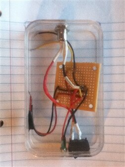

    Here is a sneak peak at what I currently have finished of my custom power supply.
    As you can see its not complete. I am waiting on the KISR33 to arrive and I havnt yet ordered the TFT LCD I am going to use.
    To simply run down on whats going on, I used a basic prototyping board to wire everything up. Power goes into the Size M DC Power Jack that can be seen on the left side. The positive wire runs to the switch you can see on the right which then runs to the PCB. The negative wire from the DC Power Jack runs directly to the PCB beside the postive connetion. (No worries, there is no short) The LED has a built in resister which you can kind of make out on its negative wire, this i connected directly to the power supplied to the board. The Black and Yellow wire you see to the left is the wire I will be using for the TFT LCD which is a direct 12v so its also connected to the power supplied to the PCB. The red and black on the bottom will go to the KISR33. Everything is encased in a recycled iPod touch box.
    IF anyone can spot any errors in my work or have any suggestion, please let me know. I know I am a beginner, so any critisicm and helpfull recommendations are welcomed.
    My only concern right now is the power cord I am currently using, (recycled I.T.E Power Supply I am not sure went to) is your basic 110-120VAC 60hz 190mA input with an output of 12V DC 750mA. I am worried that 750mA would only be enough current to efficiantly power the Pi, not the TFT LCD alongside it. Thoughts?
  • tpcipri
    tpcipri over 12 years ago in reply to toxxn
    You are right to be concerned about your 12V supply. You can calculate the power requirement by adding the loads.
    LCD Power + Pi Power + USB Power
                        75 %
    LCD Poweryou can get from the datasheet
    Pi Power = Pi chip max operating  current * 5V / efficiency (I would leave margins and use efficiency of 75%)
    USB Power = 2A * 5V (max per 2.0 spec) / efficiency
    You will need minimally a 12V/10W power supply just for max USB power requirements. Everything else should be fairly low power.
    I would look for a 12V/15W power supply which will be about double what your have.
  • toxxn
    toxxn over 12 years ago in reply to tpcipri
    Thank you for the info, I will look around for a 12v 1500mA - 2000mA supply.
