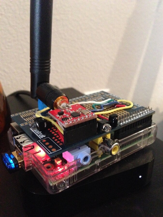

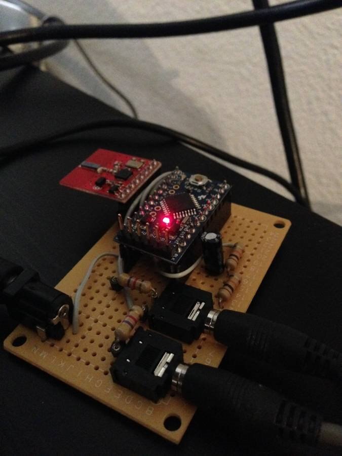

THE SOLUTION: I'm using for this project one rPI and one Arduino Pro Mini, they connect with each other using nRF24L01+, This transceiver IC operates in the 2.4GHz band, is very cheap and reliable, you can find it for 3 dollars.

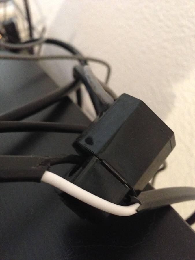

The hole of the Arduino is to detect when the apple tv is turned on, and send a message to the rPI saying that it should turn the TV on. I detect the state of the TV and apple tv by measuring the current with non-invasive current sensors.
I equipped my rPI with some IR leds and one IR receiver, so I cloned all my remotes on it using LIRC and I can control everything that has a remote control using my rPI, than I coded one simple client on rPI that keeps listening if any package was sent from the arduino, and if it receives a status saying that it should turn the tv on, it does.
