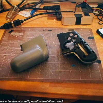

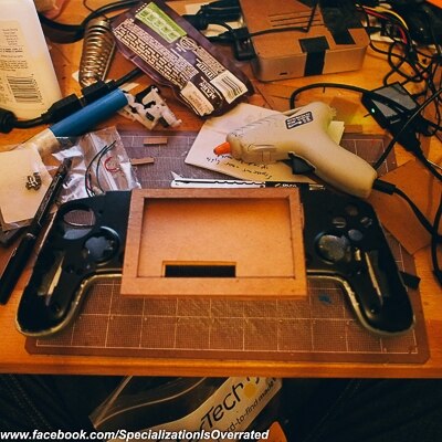

Thought I'd share the build log and progress on my own OUYA handheld build. I was hoping to finish this before Ben set his sights on the OUYA but this is my first real build so its taken me much longer than anticipated.
One of the ground rules I set up for myself on this build was that the OUYA itself not be modified and that the grips from the controller be reused so that the unit was as comfortable to hold as possible. Size wise there's nothing this one is more of a "handheld" than a "portable." The plan is to build a portable one later on. I've been at this one for a while, a little over a month.
Larger pics available at: flickr.com, search for specializationisoverrated

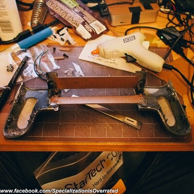

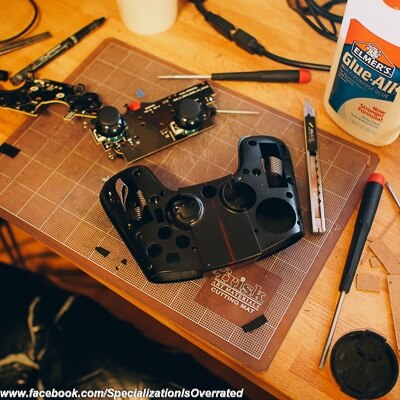

Splitting the controller housing:

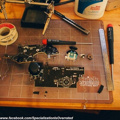

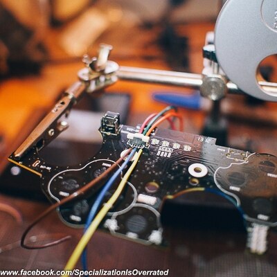

Removing analog and bumper switches from right side of board:

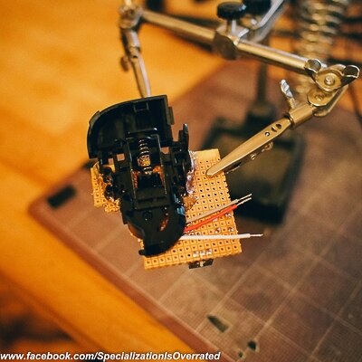

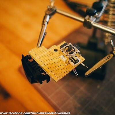

Breaking off the trigger and right analog onto some perf board:

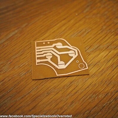

Quickly printed a new pcb for the right side buttons:

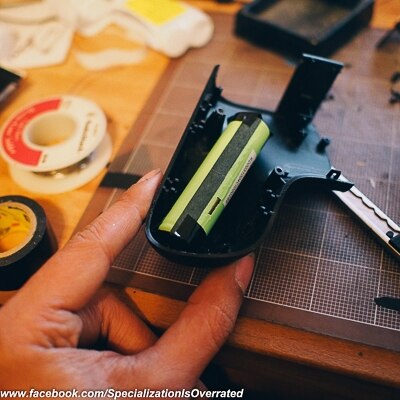

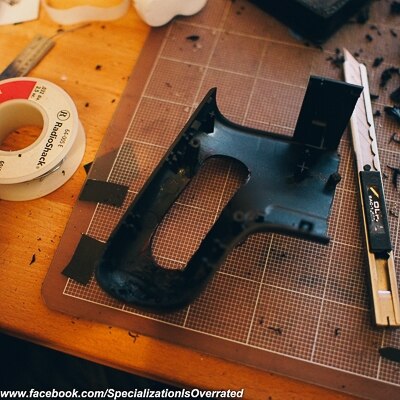

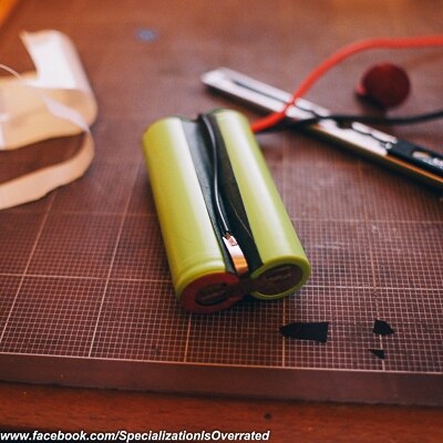

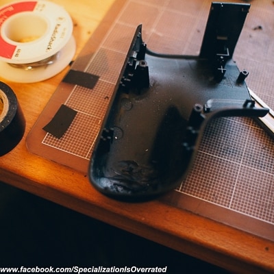

I'm using the ubiquitous 2 cell 7.4v tenergy battery to power this thing since i'm keeping the grips from the controller I thought it would be a good idea to house the new battery in roughly the same position as the in the original controller. The tenergy cells are bigger though so I had to dremel out part of the grips to make them fit.
I then got to work on the touch pad, worked out the pinout and attached leads to it.
Went back to working on the grips; I added some extra material around where I had previously made the holes to hold the battery and smoothed the whole thing so it looked like it was part of the original grip:

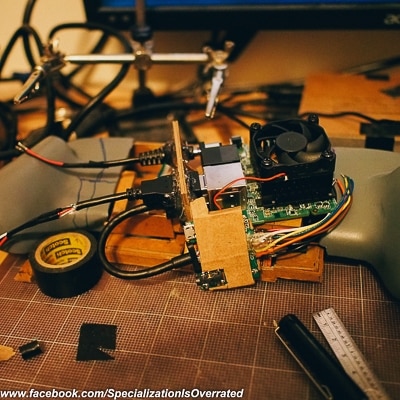

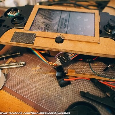

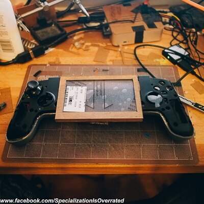

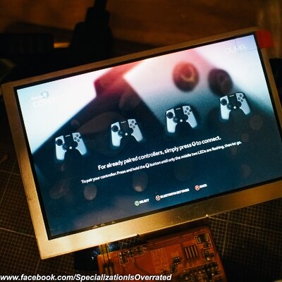

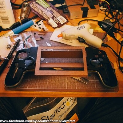

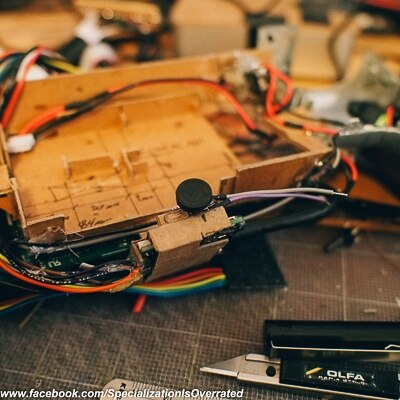

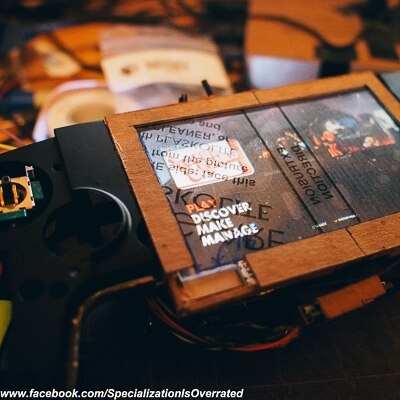

Onto the screen: Its a 5" 800x480 unit purchased on ebay. Worked out an armature to carry the screen and its controller. I don't have ready access to a 3D printer so I'm working in chipboard and styrene. I did a quick test of the screen just in case the OUYA wouldn't output to such a low resolution.
With the screen in place. I've got a piece of plexi in front of the screen to protect it.

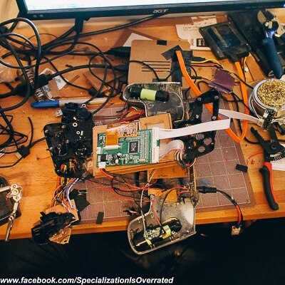

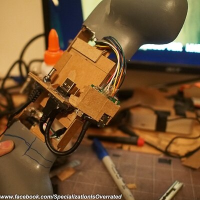

Like I said at the beginning of the post, something that was important for me on this build was the that OUYA itself not be modified. Therefore I had to create a block of ports for the OUYA to plug into and plug out of. My particular screen only came with a VGA input so i'm using an HDMI-VGA adapter to convert the signal and break out the audio from the HDMI.

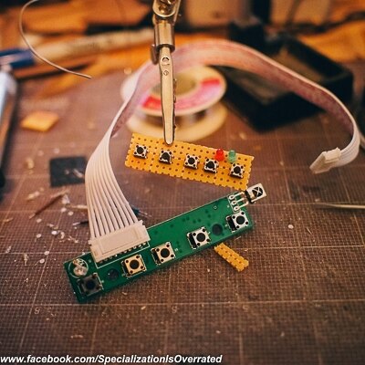

The screen came with a button board which I want to keep in the build though it's a little too big. So I made a quick slimmed down version:
What a mess image :

Working out center button placement:
Getting started on the front faceplate and the final location of the touchpad:

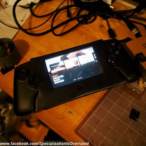

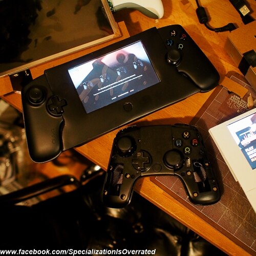

    Calling this one done. There's still a ton of stuff I'd like to do on it and its sibling but I think I'll just fold some of those into the next build. I left the plastic on the screen since I plan on using…

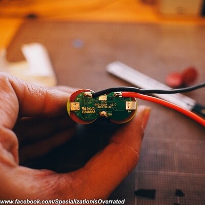

    Amazing build so far, it could be better than Ben´s if you get a nice 3D printed case. I have a question and it is how are you going to recharge your batteries if they are 2 cell?, i´m fairly new to this world.
  • eucrow
    eucrow over 12 years ago in reply to e14 Contributor
    Charging them in the same way Ben charges his in the Raspberry Pi portable vid. In my case I'm running wires to each of the controller halves. The battery pack is made up of (2) 3.7v 18650 type batteries connected in series with a circuit in-between (pics attached). Actually many battery packs are made up of 18650's. For reference they're a little taller and a little thicker than AA's.
    You can desolder them (carefully!) from the circuit board and then reconnect them to it via wire leads.  This is my first foray into working with power, my only real experience is working on photoshoots (running a few laptops and monitors without an outlet handy) but for those you use prebuilt battery packs. If you watch Ben's Pi vid, the way he wires up the batteries is such that it can't play and charge at the same time. There are threads on the Ben Heck forums that describe how to work play and charge but since this is my first one I thought I'd go with what I understand. I'm going to try and get play and charge working on V2.

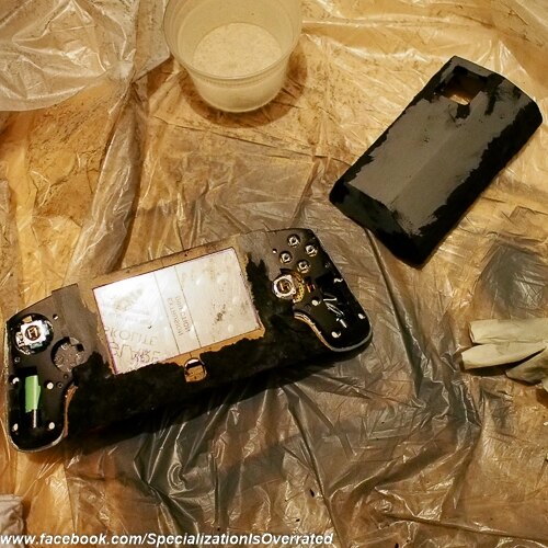

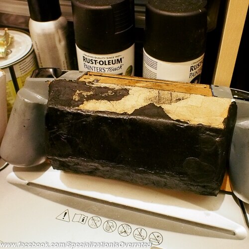

  • eucrow

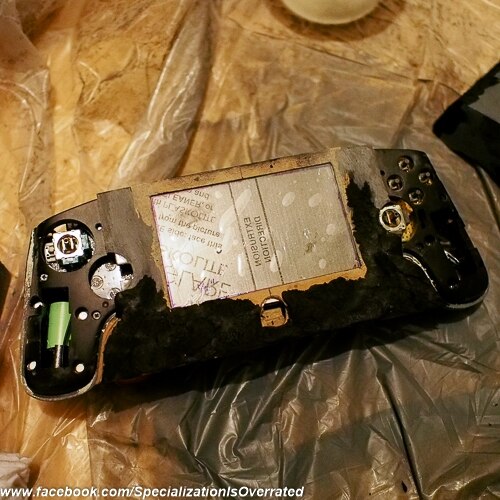

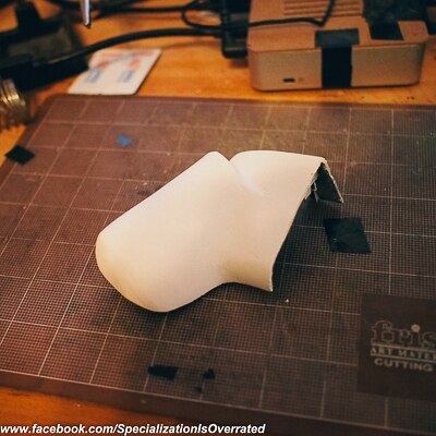

    Got some body work in over the last few evenings.
    Alternating building it up and sanding/grinding it back down.
    Just starting on the back....
    Getting started on the front bezel, you can see the back is further along at this point...
    Close up on front...
  • eucrow
    I've had to take a few days off...all the sanding was starting to wreak havoc on my sinuses. Managed to do a power on test this past Sunday just to make sure everything still worked.
