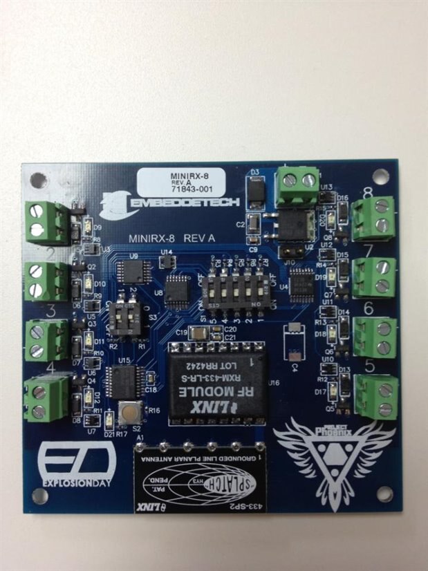

    My cousin and I built a wireless setup about 3 years ago. It uses a single 255 channel wireless receiver board and a custom PC software interface. which was far cry from my 16ch single wire prototype the year before. Just last year we added (14) 8ch mini receivers to the setup. I've attached a photo of the miniRX-8 and some links to our family's forth of July fireworks display.

    Ah Linx, I've used their radios before.  Not the cheapest in town but definitely easy.  Are you using the encoder/decoder with it as well?  Or did you roll your own protocol?
  • Former Member
    Former Member over 12 years ago in reply to colecago
    Kept the data protocol simple. The transmitter sends a single byte of data for the active channel. The mini-receiver only decodes the last 4 bits out to the 8 outputs via gates and the upper bits are manually set via switches. Linx products are little pricey but made the whole process easier. Didn't have to use a microcontroller on the receiver at all.

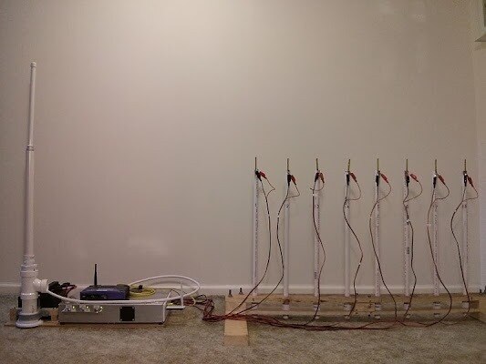

    Here is the website of the wireless fireworks igniter that I built for the Fourth of July last year.  Probably out of the low cost price range you are looking for, but it could be done cheaper; it might give you some ideas:
    http://www.flaminghellmet.com/launch/
    You could also get a commercial small 12 cue wireless firing systems from Phoenix for about $100.
