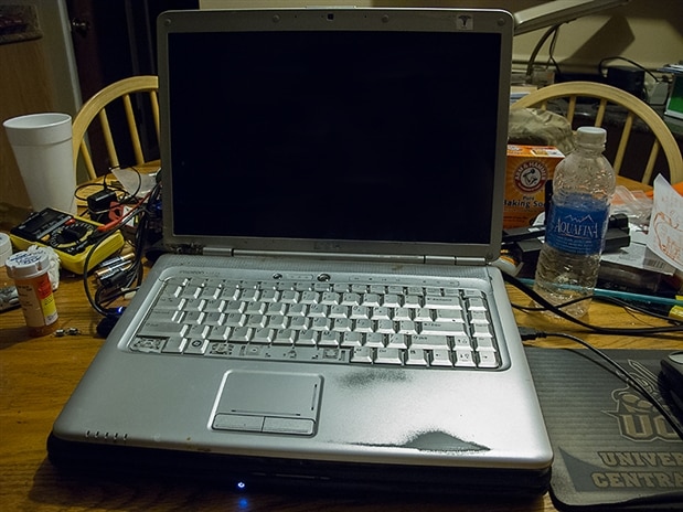

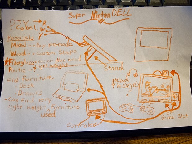

My friend's kid broke the bad news that the family Super Nintendo, a console which literally provided generations of fun, had died. I offered to fix the broken power supply but he had other ideas. "Can we make it into a GameBoy?" he asked. That sounded like a fun project to spark his interest in science and engineering, which was good enough for me. We drew up this preliminary brain storm and I decided to search for similar projects which led me here.
He offered up his GameBoy Advanced SP for parts (tiny screen and battery for a tiny handheld), but this busted up DELL Inspiron 1525 has a good screen and battery, and is prime for recycling. Instead of a handheld, we plan to transform the old console into battery powered unit which could be carried in a backpack.
I've never done a project like this before, so planning will be crucial. Any advice or links to other builds wold be very much appreciated. We will be using the M911G Lithium Ion battery from the computer. Figuring out how to safely incorporate this is my primary concern at this point. The "Materials" list in the above picture was a discussion of how to make the case. I've done a lot of work with surf boards and feel at home with fiberglass, but I'd love to soak up your thoughts on that or any other aspect of this project. Yesterday I would never have thought to be doing anything like this, so I suppose my real problem at this point is that I don't even know what I don't know.

    This is a really fun project for anyone and I am glad kids are getting to do this one as well. It will be a great learning experience for them.
    Do you already have plans for connecting the TFT Display of the Laptop to the console?
    Generally you would need a Universal LVDS Display Driver that would allow you to input VGA/ DVI into the display. In order to input Composite you would need a VGA to Composite adapter as well. Both of these are rather cheap on Ebay however. This method would be a lot easier and cheaper than converting that tiny LCD from the Gameboy to Composite

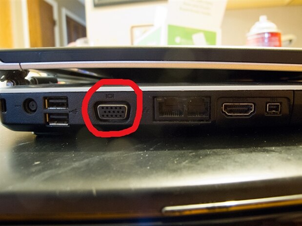

    The laptop already has a VGA plug used to hook up to a general computer monitor, I'm assuming I can use it. I simply plug a composite adapter into it which would go to the console, correct?

    If you are going to put in a laptop, then surely it would be easier to just use emulators an play lots of consoles. The laptop screen cannot be used with a SNES. That port on the side is output, not input. Fix the SNES and turn it into a gameboy with a super gameboy. Don't destroy a very fixable console.

    Yeah unfortunately most VGA ports on laptops only output. Higher end graphics cards have the ability to input via their VGA/ DVI/ HDMI ports however the general standard VGA/ HDMI ports in a laptop only output. As I was saying in my original post above, generally to recycle old laptop screens you would need a Universal LVDS Display Driver such as:
