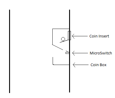

    Simplist coin mechanism is probably a slot with a micro switch inside positioned so it completely blocks the slot and is depressed when a coin is inserted. Problem is it would not be secure and could be triggered with any random long thin thing. Unfortunately the mechanisms need to be complex to prevent fraud. You could always laser cut a custom faceplate for a commercial mechanism though.
  • toxxn
    toxxn over 12 years ago in reply to kidiccurus
    For some reason it completely skipped my mind to just take out electronics all together and just use a simple microswitch.
    There are ways to somewhat go around fraud though however, such as a ramp design. Crude example below.
    This would prevent being able to stick something down in there to trip the switch. (Unless you have some extreme determination.)
    A spiral ramp type design could be used as well.
    A problem with this simple design, is the fact you could not regulate the coin itself, meaning any coin or small weighted disc would work. Unless you otherwise cut a small slit in the ramp that only a quarter, for example, could continue past, allowing anything smaller to slip through thus not activating the microswitch, but with that you also run the risk of the quarter getting stuck.
    Another problem is the fact that there would be no coin return. In the case the coin did not properly trip the microswitch, you would be kind of burnt out of luck.
    Although with my cabinet, the coin mechanism would only be for an aesthetic/ authentic feel and I would most likely add a second hidden microswitch.
    I don't expect my first full cabinet build to be perfect though.
    I just figured this would be a cool little project for anyone to try out, especially if you are going for complete customization and I would definitely love to see Ben's take on the project.

    How about this?
    A potentiometer can be used instead of the micro-switch to prevent fraud. The potentiometer will only turn a certain amount to let the coin in whereas a long object will turn it to it's max. so if a microcontroller can sense a range, than a long thin object won't be a success.
