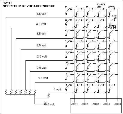

  • supper_slash
    supper_slash over 11 years ago
    How many ADC's can you have on that micro controller?
  • supper_slash
    supper_slash over 11 years ago in reply to supper_slash
    Forgive me, but would this not be an option also? If there are enough ADC's that is.
    I was working on a similar project, using a 430 MCU and it worked fine.
    Please let me know if this will not work, this set up uses a few resistors, and a supply of power to
    key-log.
    This is just a quick ruff draft, just for an example, but if the MCU has 5 ADC pins, i think this may be
    a viable option Peter.
