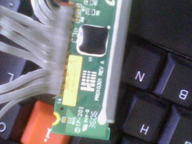

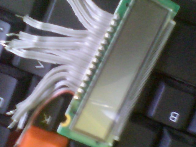

i took apart my old fax machine to salvage some stuff and i found this old 14 ping lcd i couldn't find the pinout for so can anyone please help me
i would like to interface it with my arduino
iam a newbie so i am sorry if i have asked a silly question
the no on the yellow label is HMC16103-1
if it matters

    It appears to be a standard 16 x 1 character display.
    Use it like any other non-backlight version LCD ...but configure it for 16 characters and 1 line.
    Plenty of tutorials available even on the arduino website.

    after looking through some stuff it likely follows this pinout: http://www.engineersgarage.com/electronic-components/16x2-lcd-module-datasheet
    edit: the red wire is likely ground
