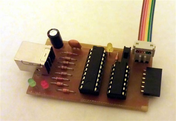

Here is my version of Adafruit's Industries USBTinyISP AVR programmer.
In my version I eliminated the 10 pin programming header, the self programming jumper and the BUS jumper.
Replaced the power out jumper with a switch and added a yellow LED to indicate 5V is going to the target device and a 6 position right angle connector for adapter boards, so you can program mass quantities of AVR MCU's.image

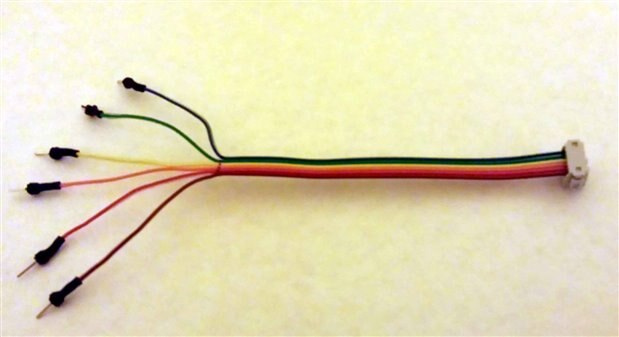

Here is a 6 pin color coded AVR cable that can be use with any 6 pin AVR programmer. One end has the standard 6 pin socket and the other end has pins so it can be used in breadboard prototyping/programming.image

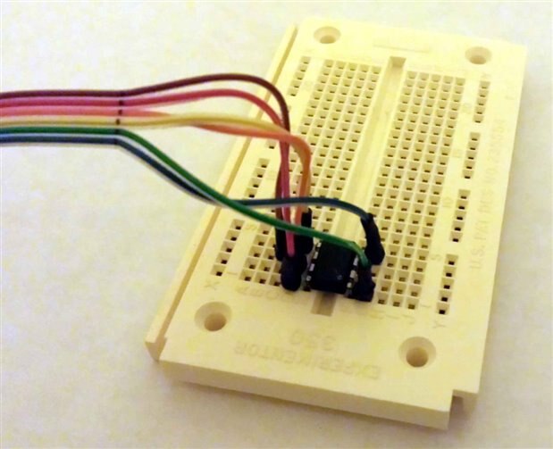

In the picture below I am programming a ATTiny45 with my setup above. image
The programmer has been tested with AVRDUDE 6.1 and everything works fine.
