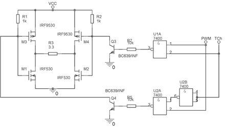

I am a volunteer paramedic for a wilderness service, i.e.,we operate in a forest area approximately 40 miles from a nearest
hospital. We need to store our pharmaceuticals between 55-80 degrees Fahrenheit year round. I have been looking for a
commercial Peltier-based system without success. All that I have found require manually switching from heating to cooling.
I think the problem may be current demands when switching polarity to achieve heating/cooling. I would like a circuit which
would -
                  - Monitor internal container temperature
                  - Monitor ambient temperatures
                  - Anticipate heating/cooling needs
                          Time of day may be an important feature, i.e., as night falls, anticipate needing heat
                  - Switch between the heating/cooling functions automatically
Critical temperature range control is not an issue as long as it can be set for a 5 - 10 degree range, e.g., 60-70 degrees would
be ideal. I would like a temperature readout and indicators for heat/cool functioning.
There are a number of portable heater/coolers at reasonable prices (we are an all-volunteer organization) which could be modified.
I have a background in analog electronics (remember mu calculations for vacuum tube-based circuits and nodal analysis?) and
have schematic and construction experience but limited printed circuit board construction skills.
Does anyone have any ideas on this? Thank you...

    e14 Contributor over 14 years ago +1
    Hi Joe, for switching current to Peltier cooler you can use H-bridge. TCh (in picture) is input for controlling heating/cooling (logic 1/0 from MCU). Peltier module is conected like R3. Three-state or…

    0 e14 Contributor over 14 years ago
    Hi Joe,
    Three-state or PSD controller is good for regulation current to Peltier with use PWM modulation (input PWM in picture).
    For measuring temperature I advice you TMP275AID.TMP275AID. sensor. All is easily implementable in MCU.
    TMP275AID.TMP275AID.: http://www.ti.com/product/tmp275
