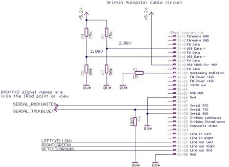

    Regarding what the pins do, here is a reverse-engineered diagram from a 'Griffin Autopilot' cable. The ones that contain the audio are pins 27 and 28. Ground is pin 29.
    If you wanted to play, or skip left/right, this is possible by using the serial RXD and TXD pins. It requires the use of a microcontroller. I did manage to get this working on an older ipod touch so I have some code snippets, but the most recent ipod may not work (I have not tried anything but the oldest ipod touch).
    If you want to do anything much more advanced, it is not possible. Apple use authentication on the serial lines for the most advanced functionality. It can be annoying. It means people need to buy Apple cables, which contain a tiny chip inside the connector, to perform the authentication.

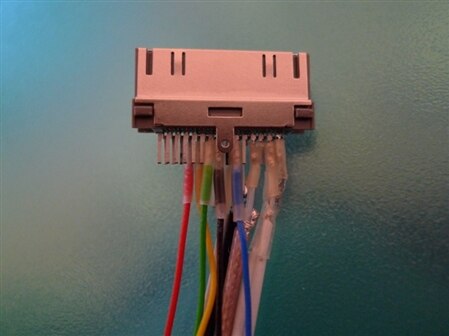

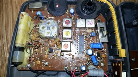

    This is what I have so far.
    I coud not figure out how to use the ipod touch adaptor cable with thirty pins. So I'll keep playing and reading about it til I get it.
    I did however get it to work with the headphone jack.
    I found the IC responsible for the amp. connected the open wires from my headphone jack. Now when I plug in my Galaxy S3 Works like a charm.
    When I plug my iPod touch it works too but has some static.
    I plug the audio+ to pin9 and ground to 11

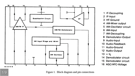

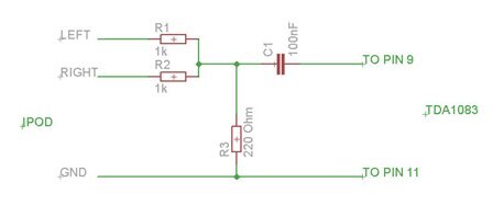

    It's likely that the ipod has too much volume for the TDA1083 (it has 40dB gain).
    Something like this should work, if you're happy adjusting the volume from the ipod rather than the radio:
    I've tried selecting values that are a compromise that should approximately work for either the line output or the headphone output.
    Note that you'll need to disable the radio audio, otherwise you'll hear it on top. In the datasheet it is a wire from pin 9 to the
    variable resistor, but the actual radio may have implemented slightly differently. You could try to remove the capacitor labelled 10nF
    in the datasheet (connected to the 120k resistor). If it is the wrong capacitor, put it back in again.
