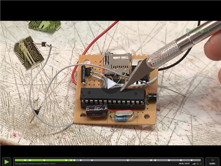

Sorry if this seems stupid, but what is the value of this resistor? I took a screenshot from the Ben Heck Show, part 2 of the Teen Texting Prevention and boxed the resistor in red. It looks like from the color a 5 bar resistor, yes all I see is 4 bars, and the bars aren't spaced evenly enough to be a 4 bar resister I believe. Any halp apreciated.

    it looks like it is direcly on crystal. And as example FT2232D use 1M for that purpose, and it looks about the same value
    And collor code says same, it is 10 and 5 zeros, aka 1MOhms
