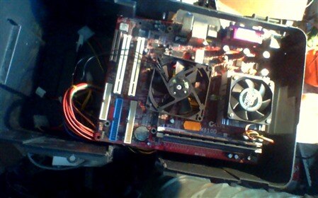

so i've been looking at one of ben's videos, and i got this wierd idea. i wanted to make my desktop pc portable.
so i made this:
and i need to somehow attach screen to it. it will be nice if someone would gave me idea how to put that together, and some tips won't be bad too.
Im looking forward to read any ansver.
  • Former Member
    0 Former Member over 12 years ago
    For mounting the internal components I suggest you cut out pieces of the old PC case with a rotary tool, you could cut out the motherboard tray, the HDD rack and Disk rack. This would give you a base to mount components on. To attach the pieces of the case to the sides of the toolbox you could use something like 10mm plastic to make platforms for the pc case parts to mount onto.

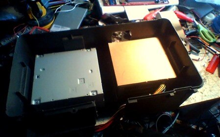

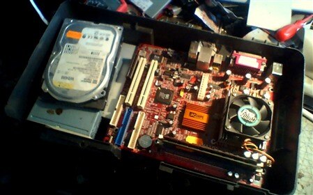

    0 msalko over 12 years ago in reply to Former Member
    Yea actualy only thing i could use from pc frame was holder for hdd and floppy disk drive and two other dvd drives. I think i have solved this part.
    I have bigger problem since this is not nevest pc, it heats a bit. Anyway i have two fans. one is munted on cpu cooler andother is from diferent pc.
    i whant to use the socond one to pump air in, so air will flow better.
    There will be top on that with holes for fans.
    Do you think it's a good idea?
